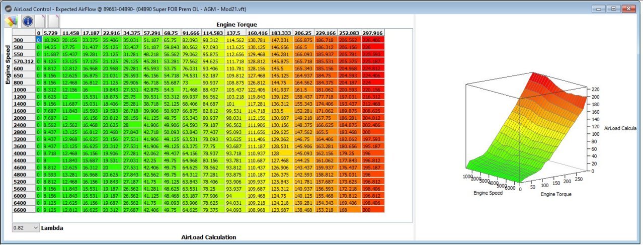

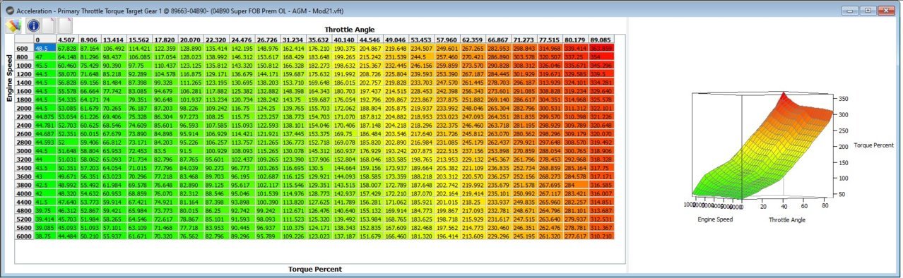

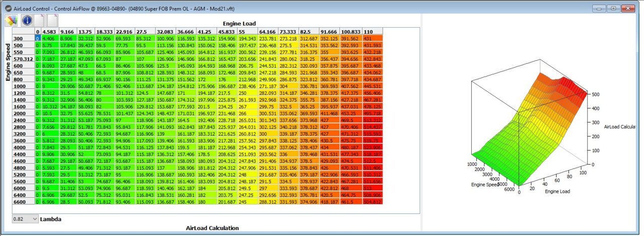

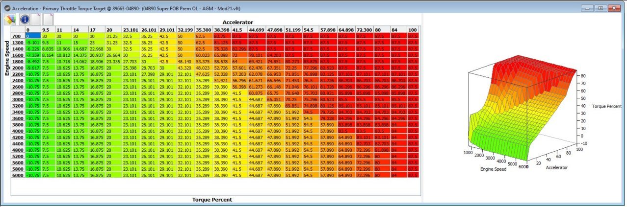

    Been having some luck with the little tinkering I have time for. I do get full throttle opening "81.96" ( OVtune said 82 was the max) at full pedal reguardless of engine load, speed, or RPM. I haven't done a log that I can post I was using OBD Fusion to watch the values while I was Driving. Even tried 35mph in 6th gear 100% pedal I saw 81.75 on the throttle position. When I get a chance to log with Techstream I will to verify.
    It's not perfect yet, but has good acceleration without the tip in being too crazy. I'm going to drive this one for a few weeks before modifying anything again.
    FYI I've Been editing 04B90 Super FOB Prem OL
    See Maps Below and spreadsheet with map values
    0.89 and 0.99 Lambda are the same using values from @tonered

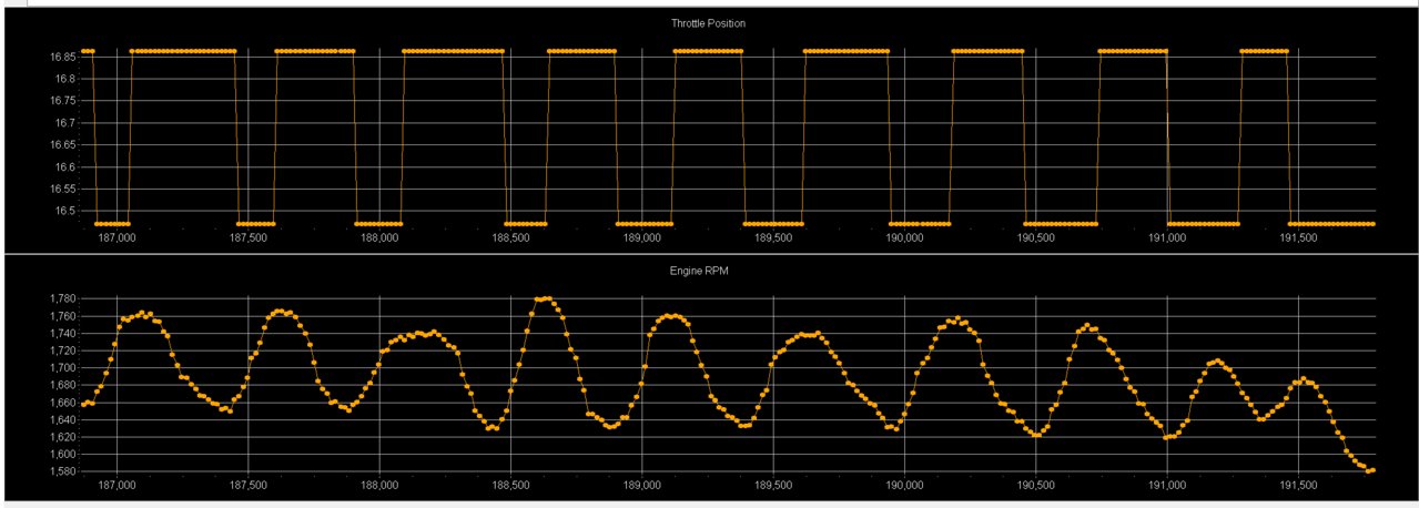

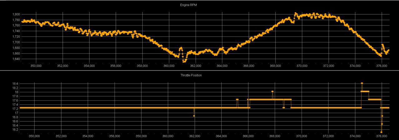

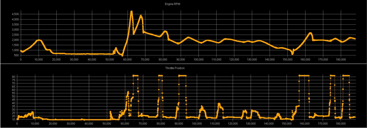

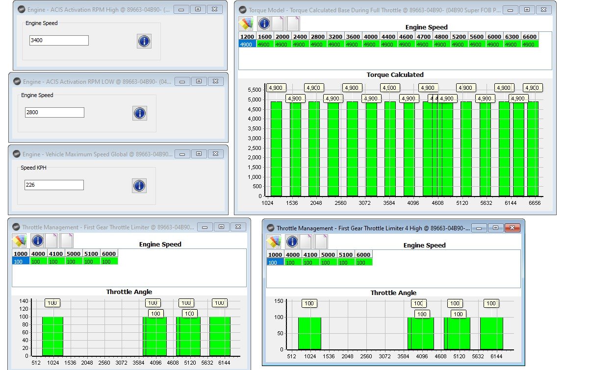

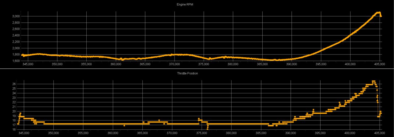

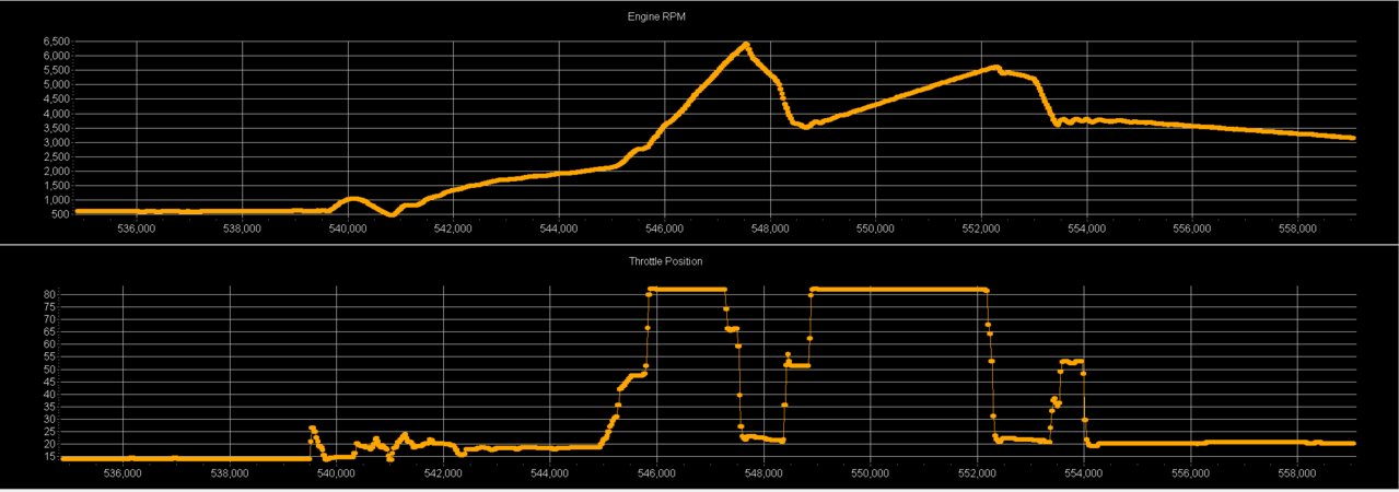

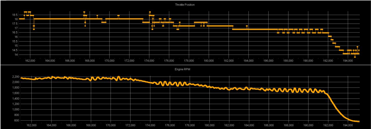

    Quoting myself here to show comparisons. @tonered @MOC221_ @DavidOverLand
    This is the file that i have now with the same conditions, light throttle, low rpm. notice the difference

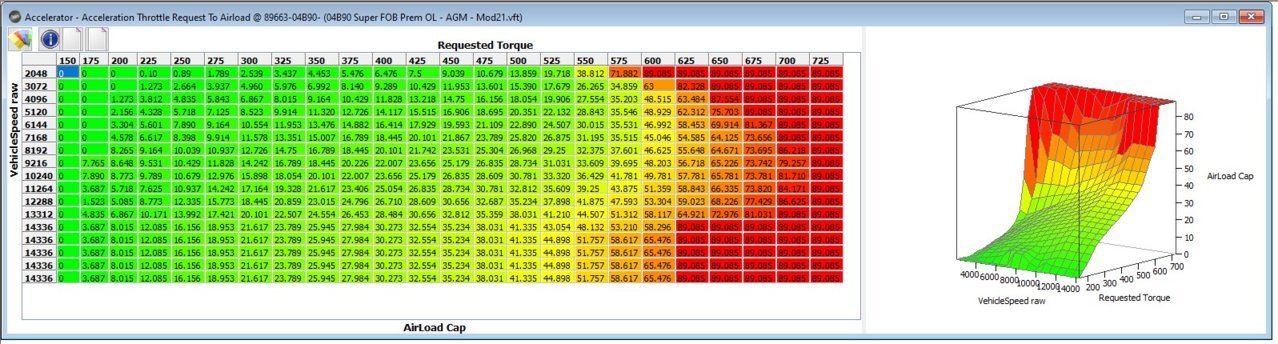

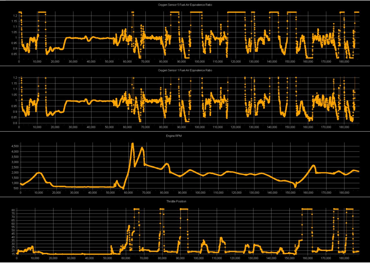

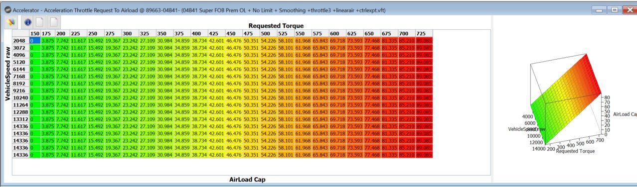

    Anyway, in addition to this. I found and eliminated my full throttle limit.
    First gear full throttle to second gear full throttle.
    3rd 4th and 5th gears various rpms
    and an overall picture with some 02 sensor logs in it as well
    The change i made, Select the whole map and hit CTRL+I
    I will as always be testing for negativities and improvements throughout the week. The most fun you can have on a rainy day. oh, and if you turn off traction control and full send in first gear, the tires wont hold....at all
    EDIT:!!! I also increased the Torque calculated during full throttle to 5000 across the board
    mZiggy, su.b.rat and tonered[OP] like this.

    Awesome you got it! I often thought of doing the control I to the accel to air load request table but was a little chicken lol. I'd like to hear your impressions on it after some time.

  9. Oct 10, 2020 at 2:54 PM
    #189
    92ehatch
    92ehatch Well-Known Member
    Jun 9, 2019
    #295818
    841
    Kinley
    Hendersonville NC
    2019 Cavalry Blue DC TRD OR 6MT
    I was scared the do it but i saw the auto guys doing something similar.
    That was one 10 min drive so too early to tell if there are any negatives but I'll keep posted if i find any at all.
    I need to do my normal commutes which involves a good mix of normal cruising, stop and go and interstate. After a few days of that i should know pretty well.

    no change from the previous file i had, except i could feel when the throttle was slapping back from 82 degrees to 40 degrees under full throttle. now i dont feel it (because its not doing it)
    im still rocking your smoothed airload tables, i like them
    tonered[QUOTED][OP] likes this.
  13. Oct 10, 2020 at 3:15 PM

  16. Oct 10, 2020 at 4:08 PM
    #196
    su.b.rat
    su.b.rat broken truck
    Jul 30, 2016
    #193316
    9,869
    this is great work, thanks for sharing again.
    as noted, i backed down to plain 04B14 SFOB 93 Dump Tubes, but with 100% throttle limits, top speed 312kph, and AGM edits. no ALC edits at all.
    i have done just one thing from this, ctrl-I on the Acceleration Throttle Request to Airload. just that, taking small steps. will report back.
    and by the way, if you haven't tried interpolating the whole Acceleration Throttle Request to Airload table, it just flattens it totally in the model. anyone know if this is a standard vF function when you select an entire table?

  20. Oct 11, 2020 at 10:32 AM
    #200
    92ehatch
    Jun 9, 2019
    #295818
    841
    Kinley
    Hendersonville NC
    Well my drive today felt great.
    Changing the throttle request to airload table to linear did make throttle response a bit touchy again (similar to my first tune edit)
    there were still some lumpy feelings in 1st and 2nd but im not sure if that was ACIS or in my throttle tables.
    I did not log this drive (should have)
    I saw no ill effects from changing that table thus far. got 21.7 mpg for the round trip (40miles) with a mix of city stop and go and highway driving.
    will continue to monitor and test
    tonered[OP], MOC221_ and CorbinDallas like this.
