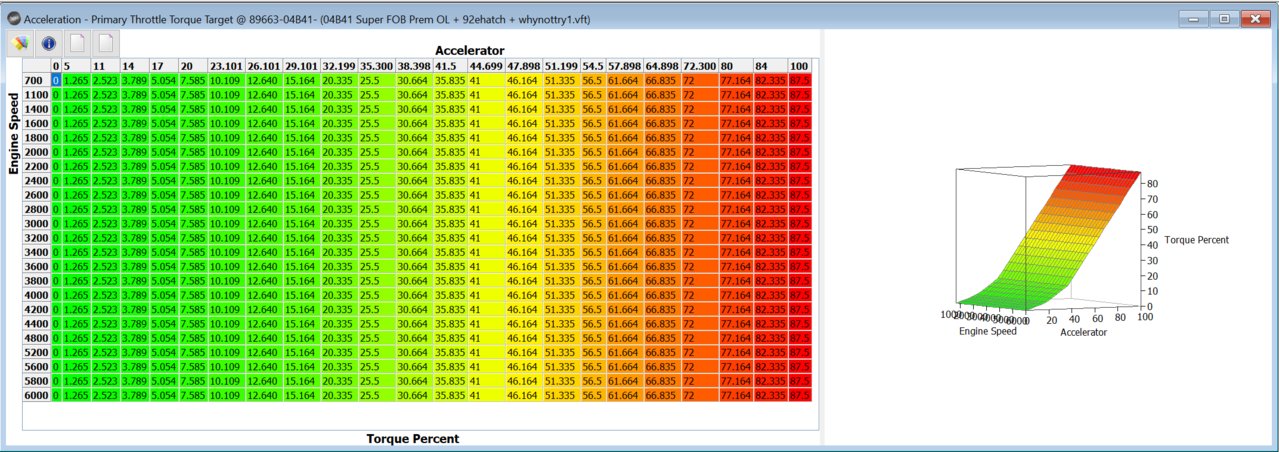

    here is a peak at what i did. like i said, the throttle at idle sucks at this point. it also has that bucking feeling back because of the jump between the -10.75 and -6.3 values. and a thud when getting back on throttle.
    Im gonna get those low end values closer and higher and find the balance.
    the point in making them all the same, i want the throttle to open and close based on my foot, not RPM, not vehicle speed, just my foot.
    Ill let the MAF and 02 sensors work their magic with Matt's fuel and timing tables to take care of the important part (not blowing up)
    I also increased the High load ACIS changeover closer to stock, cant even feel it anymore.
    I do not recommend using these at this time, the lower table maybe. The upper table will need tweaking in the 0 , 9.5, 11, 14 zones.

    On the Accelerator map, I bet if you plug that into Excel and get the bottom end to coming in a curved shape or looking more like the Throttle Angle map, you might be set?

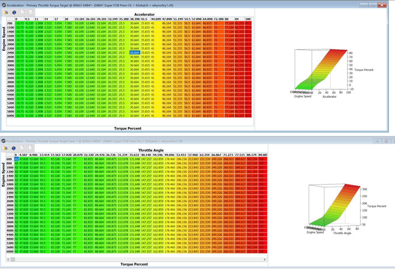

    This is what i was going to load this morning. with that said, i couldn't. I changed the 9.5 to 5 and left 11 alone.
    The last time i put full 0s in here i had a crazy sensitive throttle and lost engine braking. But i changed the first gear map so much it might be doable here.
    If this doesn't get the effect i want, will model it similar to my last one, at the lower range i will have an uptick for tip in and gradually smooth it back down to the -10 range. I just really dont want that as then i have lost the main goal, the same amount of throttle opening for every condition.
    my inital thought, this will be overly sensitive. I will probably have to back it down

    That is very interesting that this map would be more sensitive than the one above. I like the looks of this second one. LoL!

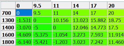

    the one above starts at -10.75 with a sharp uptick, but doesnt hit 0 until around 11 on the throttle.
    the new map starts at 0, with a soft rise untill 11
    So while the first one looks more sensitive, its actually quite dull....trust me i know, i had to drive it all day.
    the difference between 0 and -10.75 is massive (depending on the values in the other primary table)

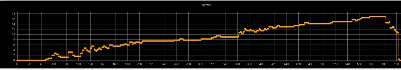

    04b41 - Matts file
    One previous file
    My last iteration (not the one i have now, i havent logged it yet)
    I tried to pick places from my logs that were similar situations, just cruising with a light throttle input.
    You can see Matts isnt bad, has some spikes and dips, to be fair i didnt log his much and didnt have any good log points to choose from. however the point is in the picture
    My previous file (that i titled the CSV "CrazyThrottle") is just that, freaking crazy
    The last file i posted about here (and sent to @MOC221_ ) smooth.
    Ill log my current one tomorrow (since i dont have anything better to do) and see how it turns out.
    EDIT: Shit, i picked the wrong PID for the last picture, ill fix it
    EDIT 2: I dont have the correct PID for that drive, oh well, will update with a log from my current one
    EDIT 3: Now i have one.

    Increase this area for the tip in at take off, just be careful, small changes make large differences.
    You can also increase the entine 0 and 9.5 range, but the more of a difference you get, the more likely you get that stutter on/off switch at low rpm low throttle.
    I found that the 700 row doesnt matter too much, but increasing the 11 and 14 column there to a higher value will give a better kick right off throttle, it will then be ignored since you arent at 700 rpm anymore
    Then increasing the 1300 in the 9.5 and 11 column will keep it moving a bit, too big of a difference i noticed creates a bit of a fall on its face effect.
    I dont know how much you apply throttle, but i find myself tipping the throttle at take off very low, but accelerating in the 30 ish range.
