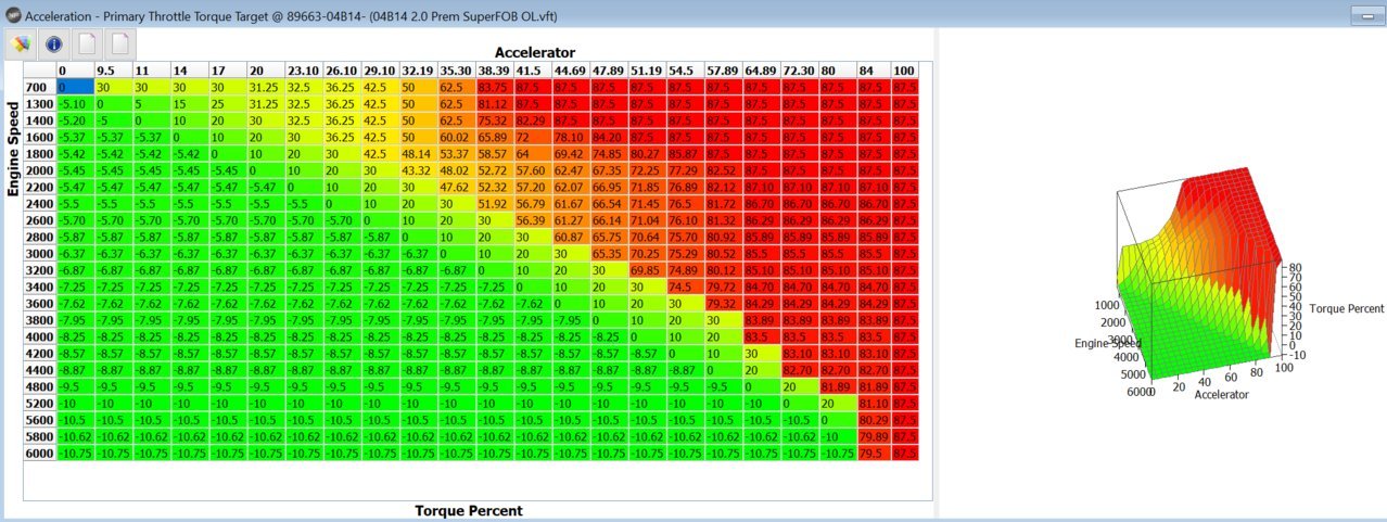

    Note that this is the Stock PTTT map:
    At my typical RPMs (1,300 to 2,600), there is not much change. The intriguing part is that when accelerating at a steady throttle (say 30%), the TB should not be closing as the revs increase. I will try to log this in the coming days.
    The one question here is if 0% means 0% TPS or 0% TB. As we know, the TB doesn't close more than about 14%.

    So just so I can get a better understanding of what the real world value of the negative values will give me, I smoothed the entire ATRA map like you did, and then I just changed the PTTT 0 column from all zeroes to all -5's and am going to flash and drive right now

    I was thinking about setting that at -10, but with the feel of V3 ALC maps, I also thought that -5 might be goodness while hoping to stay out of the on-off tip-in issue.
    Good stuff! I got full throttle in the past, but I thought it might be good insurance. We'll see what the logs show after a couple more drives.
    I'll add that to the 1st Post.
