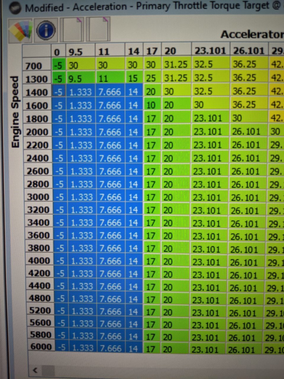

    Changing the zero column to all -5 from all 0 felt like it increased engine braking, but also made for an aggressive driving experience, especially in lower gears, and a few times seemed to fall on its face during take off in 1st, although idk if this is due to me getting used to it, or because my table goes from zero to 9.5 lol (using tonered's PTTT table from awhile back, not the one he showed this morning)

    Yeah so this is what I just tested. Took your v1 (iirc) and did the smoothing you'd recommended and tried that out yesterday and this morning, then just now tested the below map, which was just that -5 in the 0 column.
    I may change the 9.5 to 5? And then smooth? Is it worth even touching the 30's in the 700 row if they realistically wouldn't even be touched? Maybe bring them down or include in the smoothing regardless? After all, initial take off brings revs up to anywhere from 14-2k I guess ...

    tony
    Lynnwood, WA
    Yeah. If you like that map, I would say to re-smooth the first four columns with the new -5 value. I didn't like that wall between 0.0% and 9.5% Changing the axis to 5% would make it worse / steeper, IMHO?
    Even me, who does drive in very bottom of the power band, would not worry about that 30.
    Yes! Even my worst edits felt really good except for Tip In. Whether non-CC or CC. It was just too tricky and annoying, but once past tip in, it felt like a champ.

    Alright, just smoothed these, think that should be good or should I have included 1300?

    That looks good. The 1,300rpm values look great to me.
    I think you will get the smoothness and urgency from that.

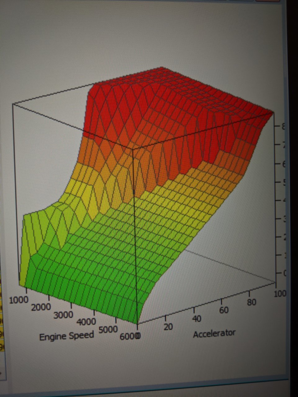

    There could certainly be more, esp if you want to get a nice curve in there.

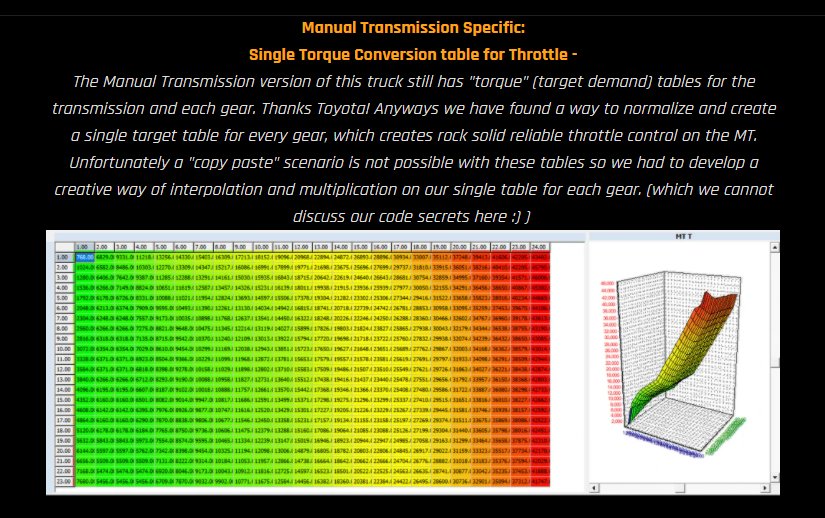

    I can't remember. Did OVT say what the actual calculations are between values and 4D maps? I can see it doing the math to the actual value or just picking the nearest. Picking the nearest would seem to take more computing / math?
    There is also this little blurb:

    Yeah. It definitely only considers the end point values. Interpolation is good. At least, I wasn't throwing extrapolation out there. :rofl::rofl:

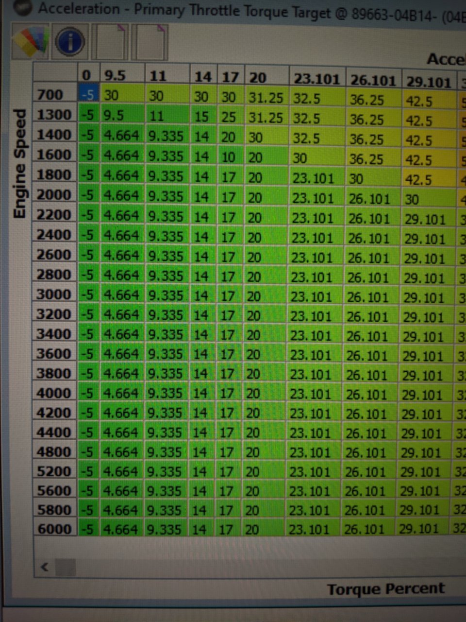

    That was a great edit. Included a picture in case anyone gets curious and tries it out. Pretty sure it's being used in conjunction with hatch's PTTG1 table.
    It's strong. Feels strong down low but appropriate. Feels very BFO down low, strong but not super light like the first FOB. Once you hit, 3500 though, in any gear, you can get moving quick, no doubt due to the other throttle modifications and the rest of this PTTT table.
