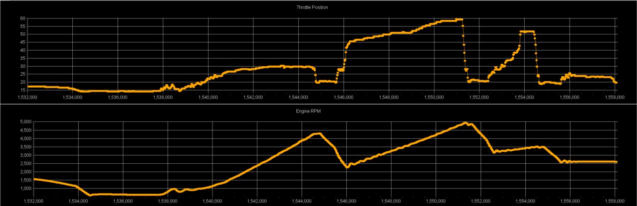

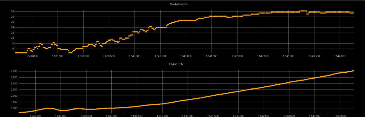

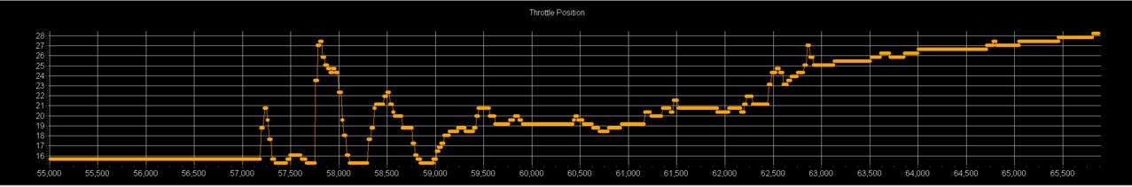

    So i updated picture 3 in this post but will put it here as well.
    Since i cant change my maps right now i logged them. Im on day 3 of the current setup and although i will change the beginning of the map, this one is by far the best, smoothest power delivery yet.
    I have gotten used to having to put a little more throttle into take off and its not a huge ordeal.
    here is the new throttle plate log with engine rpm, you will notice it is very smooth, with minimal jumps and dips. but my biggest thing. look at that RPM curve, its not jerky, its smooooooooth.
    This is a severe close up of the throttle, way less jumps and dips than ive seen in any of my logs yet.
    the beggining of this photo is my throttle modulation taking off from a stop in first gear. then a steady increase as i accelerated, i think the initial bumpiness is actually from the road i was on causing my foot to bounce on the pedal a bit.

    That smooth throttle plate log is what really spoke to me, esp with your 'before' condition of a schizo situation.

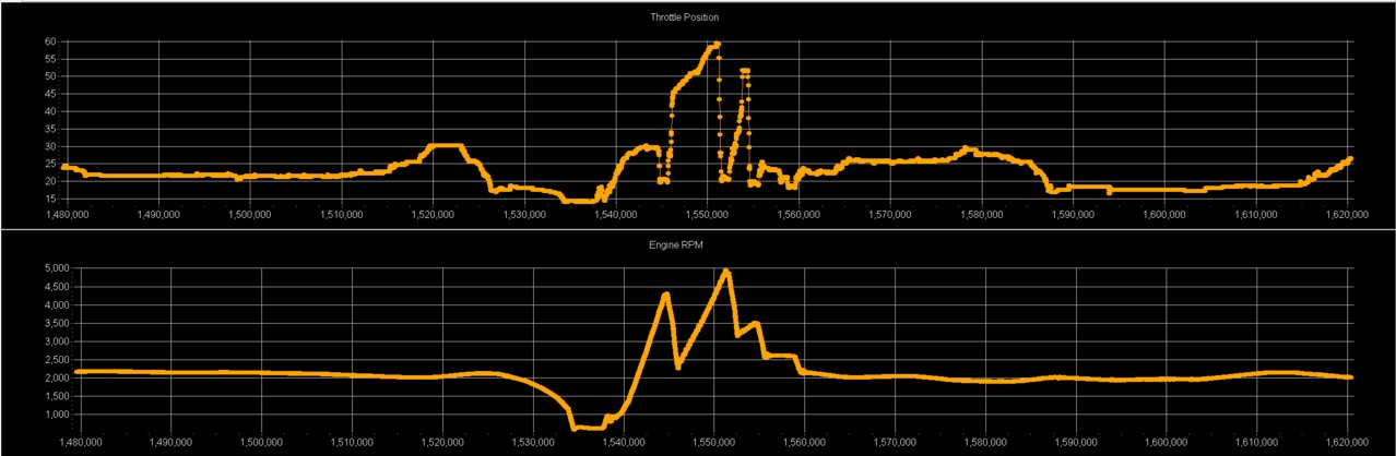

    another part of the log. beginning is a cruise in 5th gear, then moving to a stop.
    i went first to 4k and 2nd to 5k rpms then third for a moment before having to let off.
    Do you notice anything with the throttle position and rpms in this log?

    I'm seeing the TB snapping shut, or as shut as it going to go.
    The increases are almost linear also, esp 2nd gear. I think that contributes to the smooth feeling.

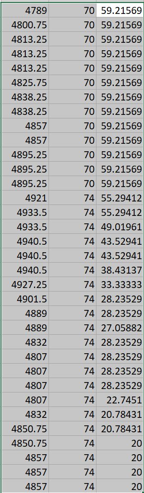

    here is a shot of the CSV (if you use matts logger you will see how fast it logs stuff)
    Left RPM, Middle Speed KPH, Right Throttle Angle
    according to this, it hung at 59 for a moment, but given that this is a motor driven thing, it has to stop and then reverse
    tonered[QUOTED][OP] likes this.

    Yes. The logger rate is very fast. That is a quick TB closing.
