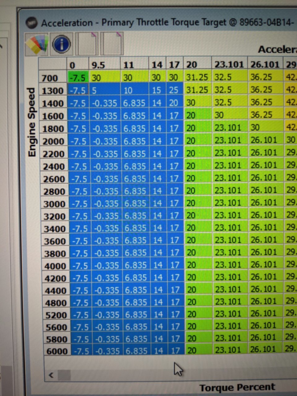

    Alright, so I went into the hyper linear throttle map I've got as a back up to try out (copied what @tonered had posted up) and removed hatch's PTTG1 from that, removed it from my own unintentional SFOB REG Performance map that I'm trying out as well. Turns out I had already done the CTRL-I smoothing for the accel-airload table. I suspect I didn't name the file accordingly because it gets on my nerves when the file names are exceedingly long lol
    Revisited the PTTT table yet again and made the first column -7.5 per friendly suggestion (which should also increase some engine braking too, no @MOC221_ ? so that's a win anyway) and then made the change shown below.
    Re-smoothed the first four columns from 1400rpm up, and I've got the fifth column highlighted just because there was an odd torque dip in there that I'd happened to see at Accelerator 17, 1600 rpm iirc. Going down the column it read 20, 10, 17, 17, it was just random and weird, took that out.
    Will test. If this doesn't work out, or if it's at least not super close to what I'm looking for overall, I'll probably abandon this line of tinkering and just throw up the map for others to grab and use if they want. These edits haven't been bad at all, they've resulted in very fun, aggressive and smooth driving. Just not how I want to drive my truck. Lol

    Yes going more negative in that left most column (full lift on the accelerator) on the PTTT map should increase engine braking in my experience. I've not tried putting the exact same values down that whole column yet though.. I'm using a "stock" config for that map right now. I want to see how my current combo works out and THEN fuck with the PTTT.

    Ugh. Alright, so I guess I need to either reapply hatch's PTTG1 map or return the 1st column of the PTTT to -5
    Throttle isn't as sensitive. Nearly identical to Mat's SFOB Reg that I'm using as my base. I've now returned to needing to double tap the pedal when downshifting into 2nd to get the revs to come up anywhere above 2800-3k. That dead pedal feeling you get the first time you press. Smh.
    Everything else is pretty great so far. :notsure:

    Just curious. Are you tapping at just the start of the pedal when blipping? I am finding that just like the in-gear throttle, I need to get into it a bit deeper for rev matching. On larger downshifts, it is sometimes a fast stab to the floor, but there is no deadness, just what I would still call linear response?

    I guess I'm just tapping because for the other gears, a tap gets you right to where you need to be. This isn't the case for 2nd since I typically downshift into it at 35-50mph, and so I need on average to hit 3k to almost 5k rpm.
    Going deeper into the pedal for a longer and more deliberate press will absolutely be a learning curve then, and not at all what I'm used to for downshifting. More ugh.

    On my more aggressive previous revision it was excellent. Tap it like I'm used to and bam, I was where I needed to be. Lol

    To me it seems slow and irritating. So I've gotta decide what I want to do

    Did you change the gear 1 table at all?
    If you did then that will affect this as well.
    In my maps i last posted i had a hybrid of stock in the low end and ov tunes in the high end.
    If you return that back tho ovtunes it will increase throttle sensitivity. I found it to be too sensitive
