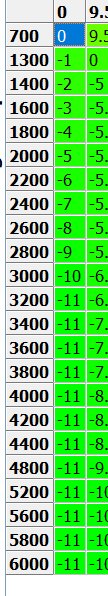

    On the Primary Throttle map - has anyone tried to enter values more negative than -10.75 (or whatever the max stock value is) under the full lift column just for shits n giggles?

    Ah. I get you.
    Yes. Goofing up in this area of the maps is inconsequential and good for learning.

    -15 to know for sure.

    I was thinking of trying max negative values all the way down that column.

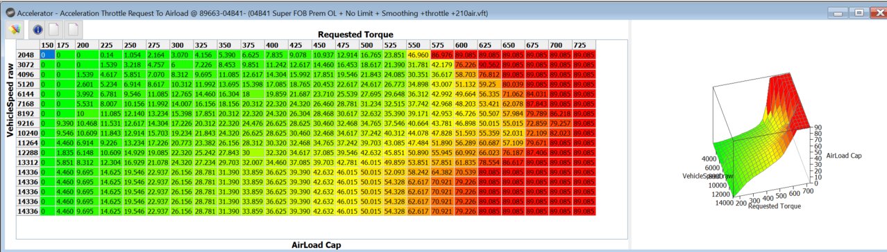

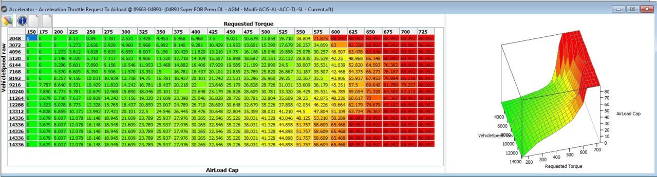

    I'm thinking it has to do with this table but I'm not sure what the raw speed equates to in MPH....

    I modified that air load table a bit and can put it in an excel file for you if you would like
    tonered[OP] likes this.
    tonered[OP] and Supr4Lo like this.

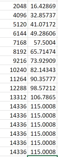

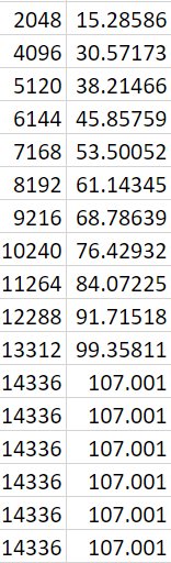

    as far as raw speed. I think the governor for the speed is 115. if you divide 14336 by 115 you get 124.66.
    so if you divide all the raw values by 124.66 that may be the speeds the table references.
    so something like this possibly
    VF shows the top speed is 107 in MPH so i redid it with that as well

    Ahhh, yes this would make perfect scene. Thanks!
