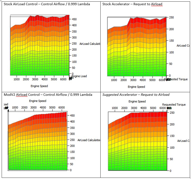

    Take a look at the Accelerator - Request to Airload table. The graph looks similar to the Airload Control - Control Airflow 0.999 Lambda table.
    I'm thinking modifying one parameter isn't enough if that parameter references other tables.

  18. Oct 15, 2020 at 8:34 PM
    #418
    su.b.rat

    you mean always keep these in sync however you change them?

    That would be my guess. I have no way to confirm what the Accelerator - Request to Airload table affects.
    I'll apply the changes this weekend to see if the butt dyno can tell a difference.

    True, but I definitely had issues with a small change in one section of the ALC maps. Going linear on the ATRA only seemed to do good things?
