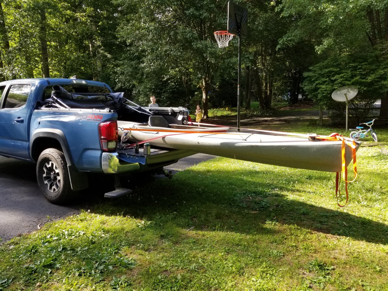

    Been kayak fishing since i was 14.
    I have 4 now, my original I've had since a teen, a 12 ft field and stream
    My wife got me the pescador pilot for my birthday and i just picked up the native propel last week for a steal.
    We are in a month long tourney and skunked the first weekend, didn't get to fish due to hurricane delta last week. With kids and Halloween we are looking at this weekend being a fishing weekend.
    First time out with the native, wife's first pedal trip.

    She's gonna a love it.
    I'm in a 10ft sit in. Been wanting one for ages and finally pulled the trigger last year. I definitely squandered this summer. Motivation is low all around.
    Good luck!

    If you are fishing out of it a pedal is well with it.
    I use my sit in 14 foot for the river. Light weight, tracks well with current.
    Not so good in the back of the Tacoma
    tonered[QUOTED][OP] likes this.
