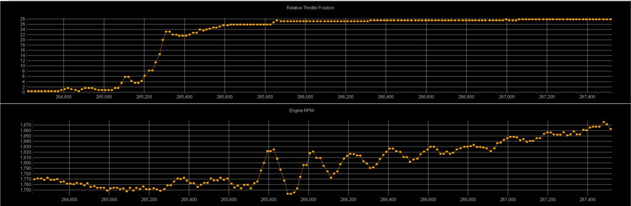

    i finally captured some of the "tugging" bumpy road feeling that i get on my 2019. This is mostly prevalent with medium throttle input under higher loads.
    This was uphill, in 4th gear, just giving it a medium throttle input. you can feel it lunging slightly as you accelerate. it typically smooths out and goes away around 2500 rpms
    look at the rpms, up down up down up down. but the throttle input is fairly steady. unfortunately the only throttle i grabbed was "relative" somehow i didnt get the actual in there.
    @OVTune any thoughts on this?

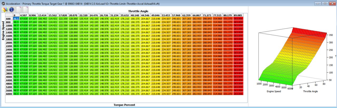

    I did this to the PTTTG1 tables and have been driving on it for the past few days. Butt dyno says 1st gear has more torque. I didn't create any of these values. I grabbed the ones already there and pasted it for each rpm range.

    i did this in one of my files but changed it back to test other things after i found some changes in how my throttle was reacting. it felt good but im questioning whether it is a good idea or not.
  13. Oct 22, 2020 at 3:26 AM
    #473
    92ehatch
    92ehatch Well-Known Member
    Jun 9, 2019
    #295818
    841
    Kinley
    Hendersonville NC
    2019 Cavalry Blue DC TRD OR 6MT
    I'm beginning to think this is not tune related.
    I have the slip yoke clunk as well (the thud that happens after you stop)
    I'm thinking this is the same thing in reverse.
    Ie: you apply moderate throttle and the torque lifts the front of the differential (axle wrap)
    As it attempts to return to a neutral position the slip yoke binds then releases causing a thud as it releases (front of differential drops)
    Then like a rubber band it repeats this slightly less severely until it settles out.
    The binding and releasing could cause the rpms to raise (binding releases) and lower (binds)
    Especially since this is only happening during higher load and lower speed acceleration.
    Anyone else have thoughts on this theory?
    This would also help explain why i don't have this problem when I'm towing my trailer (John boat trailer) it's only a few hundred pounds but it's keeping the leafs loaded more
    tonered[OP] likes this.

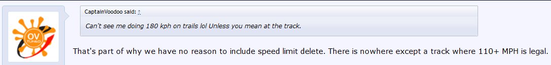

    I know Mat never removed the speed limiter from his tune. 115 MPH is way beyond the legal limit, and beyond the limit of most of the tires guys throw on their trucks, so maybe there's a liability issue if people start blowing tires.

    You can raise your limiter in vF Tuner yourself. People have been setting it to max, 312kph
