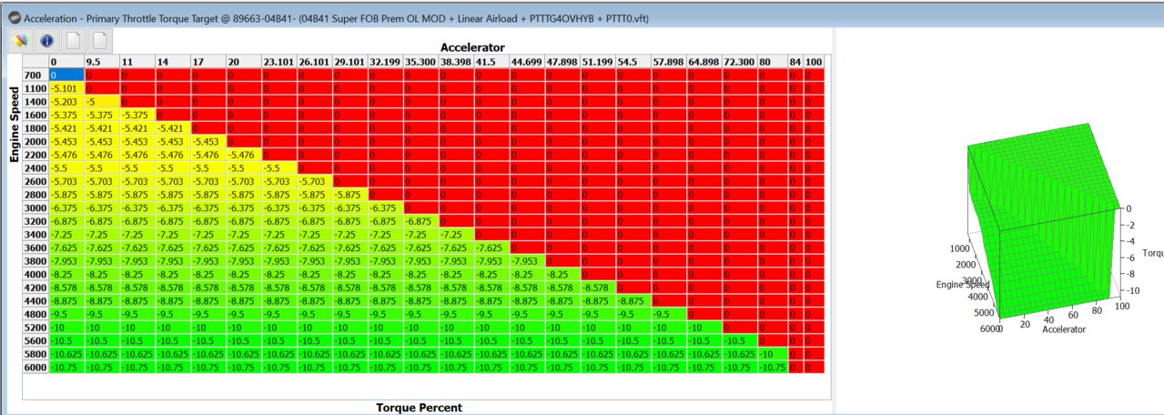

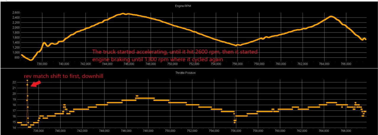

    if you had to guess what happened when i did this, what would you say. (and i dont know why the 3d graph turned green all the way)
    it didn't make me not accelerate, im not sure what it did actually, your guess would be as good as mine.
    We all know when we change the far left to 0 that engine braking was negatively affected.
    i would say that engine braking was still affected by this in a negative way as i was driving i noticed strange off throttle behavior even in gear at 3000 rpms.
    once i got back onto the road i live on (has a nice long downhill section) i tested it in first gear.
    in the picture below is a 1st gear, downhill, with NO throttle pedal input. Im so confused.
    im gonna dump them all to -10.75 and try again.
    DISCLAIMER: I dont recommend trying these things, try at your own risk. I have a good section of road to test this on where traffic wouldnt be an issue if my truck explodes.

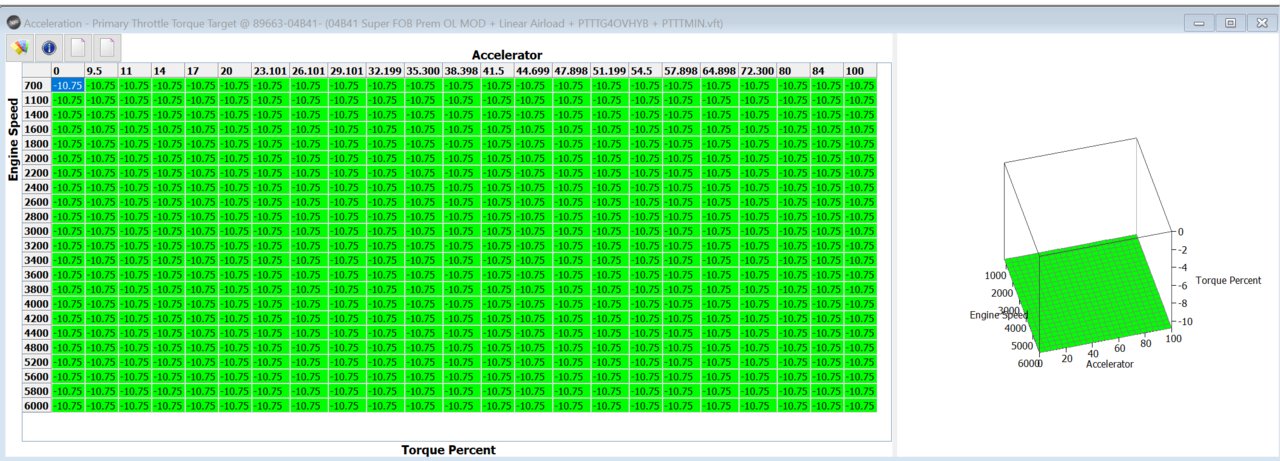

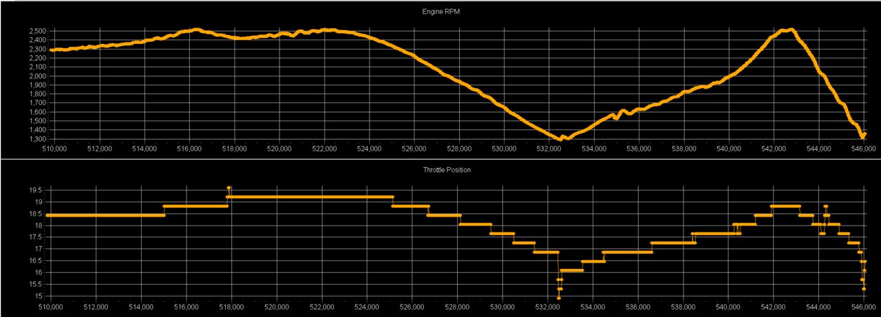

    yeah i dont have a clue what this table does actually. it doesnt seem to affect when accelerating, it doesnt seem to affect decelerating.
    or the truck just ignores it because of the WTF im putting into it.
    or the changes this table makes are so minute that i cant feel it.
    everything about this truck has been so random.
    I put the map in with the above values (all -10.75) i felt no difference
    same hill in first gear as before
