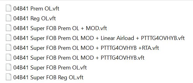

    After doing those changes, save your file. This is your new baseline. Any additional changes you make, export your new file with a new name and make the changes you want, then save. This will keep the STOCK 2.0 tune with your Baseline changes for future modifications, or if you wish to start over (like i did)
    example:
    As you see, MOD is my baseline. PTTG4OVHYB is my PTTG1 Table only, then i added Request to Airload (RTA) (my current file im personally running) and Linear throttle request to Airload, which i have not tried yet with this file (i have a different idea for this that i will test and update my findings)
    Now like i have said, i have tested many many many different scenarios. I have sent some to a couple of people. some are running some of my stuff, some didnt like it. These changes only change throttle response, etc. They are feel based. You may not like what someone else did. In the end, so far im only running 2 modifications from my "BaseLine" I have saved files from the ones i sent to other people, because i like them too, but they are not perfect, so im still working.

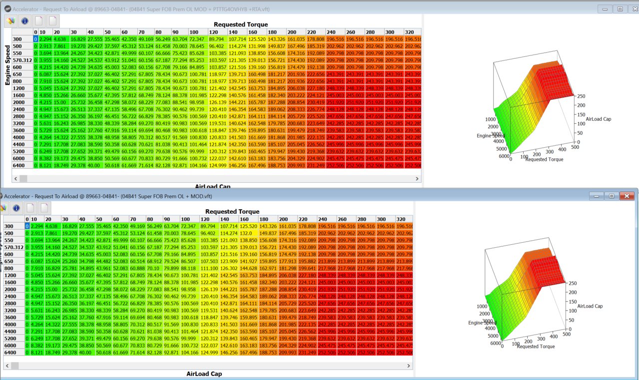

    On the Request to airload table i only changed 2 lines. The top is modified, the bottom is stock (and ovtune) I honestly dont know if i feel a difference in this change or not. but it didnt do anything negative, so im not changing it back.
    650 and 800 RPM - sorry im not making a spread sheet for those two lines if you wish to have these values just add them to one line and copy to the other.

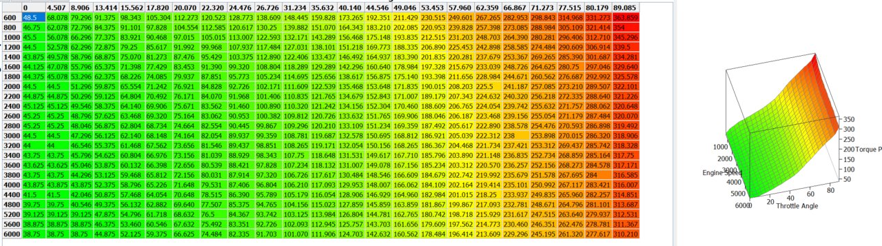

    My next change will be to the Throttle request to airload table. Making it linear (ctrl+i) on the whole map, works really well, if you wish to do that, do that. I currently have it stock, but am at minimum going to linear until i find a reason to do otherwise.
    now, to the PTTT table. As i said, i decided to make the whole map THE WHOLE THING 0. It changed stuff, but it didnt do anything detrimental, i could still accelerate (slower) and it had less engine braking (alot)
    Then i made the whole table -10.75 (the current lowest value, i have gone lower without ill effects) This change made no difference from 0 EXCEPT that one time, on one shift, it thunked HARD, i mean HARD when i let off the throttle and pushed the clutch. However it did not do what i thought it would.
    Im currently on the STOCK PTTTT table, BUT you can also make it linear (which is smooth as silk BTW) Tony has a good one, i would use his if you wish to go that route. HOWEVER, his minimum values in the 0 range do seem to affect engine braking some.
    In the end, the best and biggest effects i have felt is to the PTTTG1 table. You can easily make your truck accelerate way to agressively and jerky, or you can make it so bad you can barely take off on a hill (i got stuck with that one for a week almost when my computer updated and changed my system ID)

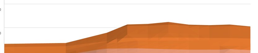

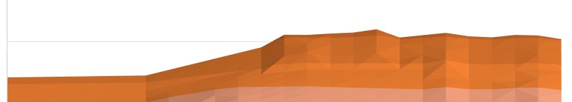

    I am just wondering what you are seeing in Column R? That would be the top of the rotated map here:
    I smoothed a few of the values to eliminate creases. This is what that map looked like without smoothing:
    :cheers:
