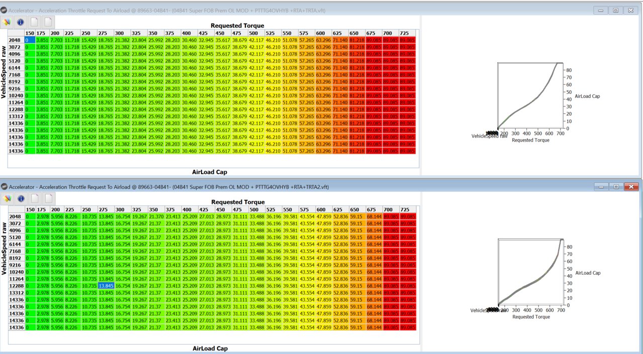

    Load the ptttg1 map i posted for you in the quick write up.
    It does this

    Ok, made your changes @tonered. Going to flash :)

    Well, that felt great! Much better (smoother) throttle. Power in gears felt good all around. Only 10 miles on so far (mixed highway and city stop and go)
    Going to be filling up later today and will continue to monitor, but as of now, I might be on this file for some time. Thank you @tonered for all your help!
