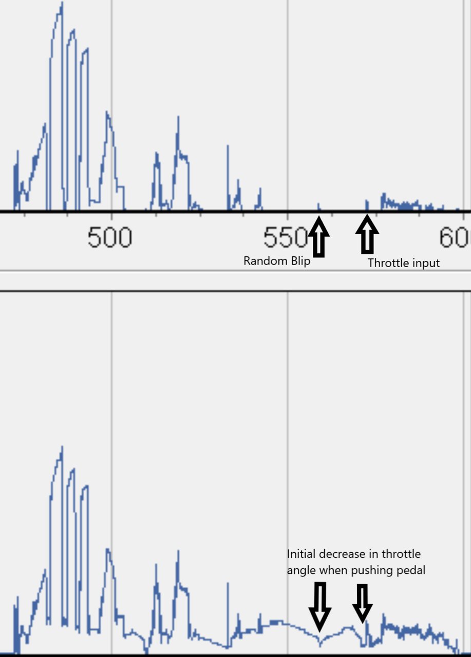

    So i went -12 all the way down the primary table and tried again. Same result, sluggish throttle response.
    I also ran a test
    I shifted out of gear without using the clutch. Still rev hangs. Verified in csv log. Throttle goes from 20 to 21 and sits there for a moment before running down to 17.
    It appears that we need more maps in vf tuner.
    Also no change to dfco. I'll stick to pushing the clutch in at 1500.
    I'm going to load my other file with tonys air table and see how it compares.
    For now on it appears to be a sit and wait thing

    That is completely fucked up, but on target with respect to the base tune that Toyota gave us.
    Great work though!
    Before they fixed the road near my house, we had a half mile downhill backup, where it was mainly doing a slow crawl in 1st gear. On Stock and 1.05, the throttle in coast / DFCO was completely unpredictable. Sometimes, it would go into DFCO, and sometimes, it would hang and never slow. I did find that tapping the brake enough to trigger the brake light would at least get DFCO to kick in.
    I could experiment with dropping off the throttle high up or below the old DFCO Cut In at 1,400rpm and get different results. Not to mention the unpredictable nature of the injectors turning back on and shooting me forward.
    2.0 is a lot better, but clearly, there is still fucked up logic in the throttle control.
    Yes. As you increase speed, throttle and fuel flow (!) is increased when in DFCO. Makes zero sense.
    I cannot imagine how this would be good for efficiency or emissions. I know there is some rationale for Rev Hangs, but even then, what folks do to avoid Rev Hang has to be work than the original problem.
    Thanks again for doing this and confirming!
