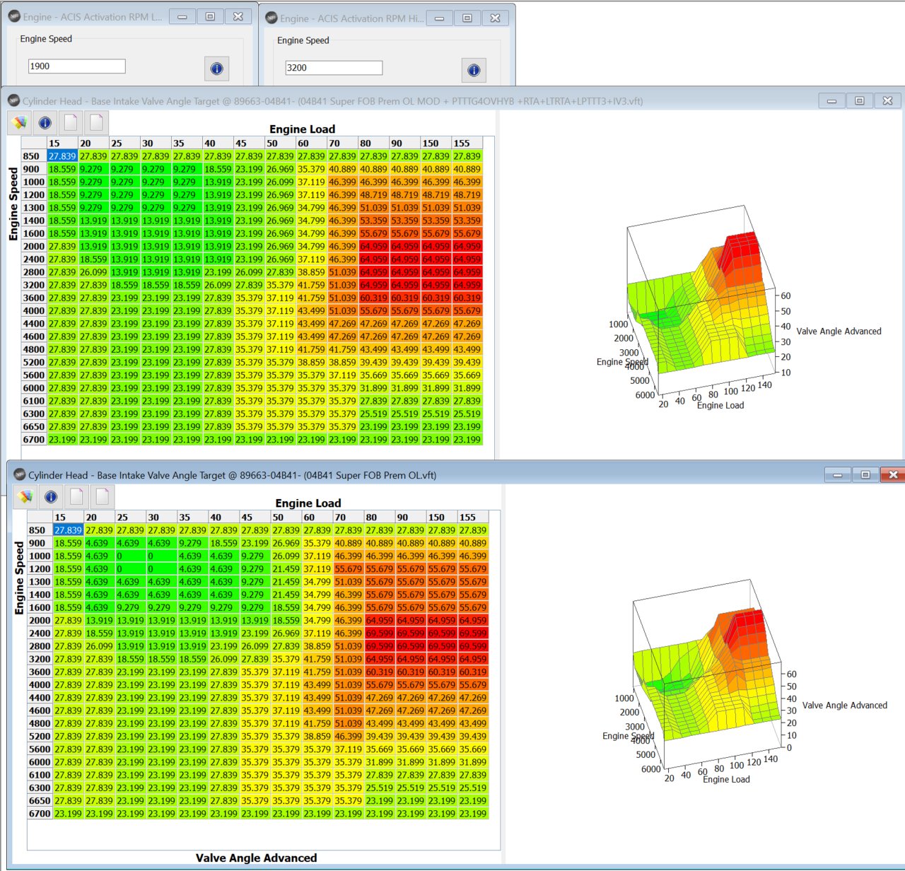

    I've since advanced the valves further in the lower load and rpm range and it has as nice burble burble to it...

    If you get the excel sheet, it has every edit i did.
    You can copy the entire cells and paste them.
    I can update with the new valve tables, just give me a minute to load it up on my computer
    Note I'm seeing slightly lower gas mileage at my current advances (more resistance at lower rpm)

    here is the updated file with what i have now. ive only ran this one for 2 days, but i like it.
    it has a different intake valve advance and a different acis high and low activation
    im not sure i like the current acis. im still playing with it.
    first valve is what im running, second valve image is the ovtune SFOB setup
