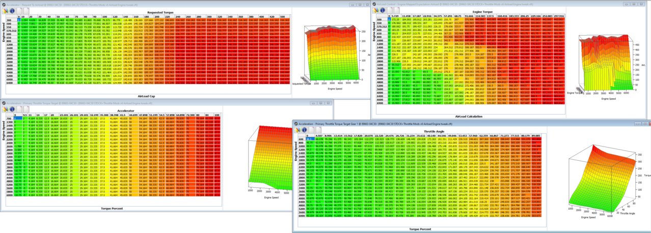

    Have any of you modified the Request to Airload or Engine Mapped Expectation Airload tables? What did you find?
    I did modify both of them, the former first and then the latter (with a bit of driving in between) with the goal to try and eliminate the lag/loss of power upon shifting into the low end of the gear (the tables and graphs even show much lower than 1k+ RPM). All I did was select said range and multiply by 110 to make it more flush

    I did adjust the lower end of the request to air load table but did not notice a change.
    The only way i found to get rid of that lag is to press the throttle just moments before fully letting off the clutch pedal

    What does your primary throttle torque table look like?
    And the first gear table?
    The over rev i did fix

    This is what I did to the tables. Simply the top left where it seems to be dropped off under high load and low RPM I boosted by 10% to bring the numbers more in line with the rest of the graph/table.
    I'd like to ask about the overrev business. I think I have that issue, too. I feel it's often too much or too little? It's probably just me trying too hard (I find if i think about it a lot and try I can do worse than just driving) but I'm curious anyway.

    If you guys look in this excel sheet you can see my pttt and ptttg1 values.
    It removes the touchiness of the throttle and is the core of what i did this make mine smooth.
    Note, it takes a few tries to get used to the throttle, you can't just blip it anymore, you have to hold it a bit (more like a cable throttle)
    But it stops that initial throttle press from jumping way up and then slamming back down on you.

    Those are the same tables that I have in my stock edit. I need to give you credit as they are incredible. Thank you for your hard work on them and for sharing.
    I found the throttle was (and is) very normal. The throttle before any tune on this or the AT I had were weird. I was okay with adjusting to it (like any other vehicle) but what I wasn't hot on was the unpredictability of it (and the shifting behaviour in the AT). Now, there are none of those (or very minor and hardly, if at all, noticeable)
