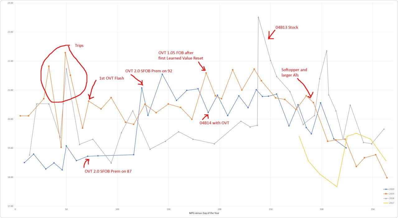

    Winter fuel and cold temps will mess with your MPGs. I have noticed that the tunes are affected a bit more by cold temps.
    You could try Base Reg with or without the edits?
    I am running SFOB Prem on 87. But, @OVTune did say that Prem tunes on regular octane may perform worse than Reg tunes as the ignition has to adjust further from the initial set point. I do not know if 'perform' means general driveability and MPGs or outright performance. All that I can say is right now with the edited SFOB Prem on 87, I am really happy overall.
    Just in case, here's my MPG tracking. You can see those MPG trends in the colder months. The peaks are mostly trips were one tank would get really nice MPGs (Stock and tuned) and the next would take a dip.

    Thanks - winter fuel was certainly something I was curious about. The last time I did this trip was in October and it was in the 70s, this past weekend it was in the 40/50s. I think my biggest issue right now is that I have such a small sample size (340 miles on a single tank) is really not much to go off of. I think I'll keep running this tune for at least a couple more tanks just to see if it all evens out since I think I read that it takes a few tanks for the truck to adapt.
    I like how you've logged your MPGs and I think I'll start doing something like that to see how things change with tires/lift/armor/etc.
