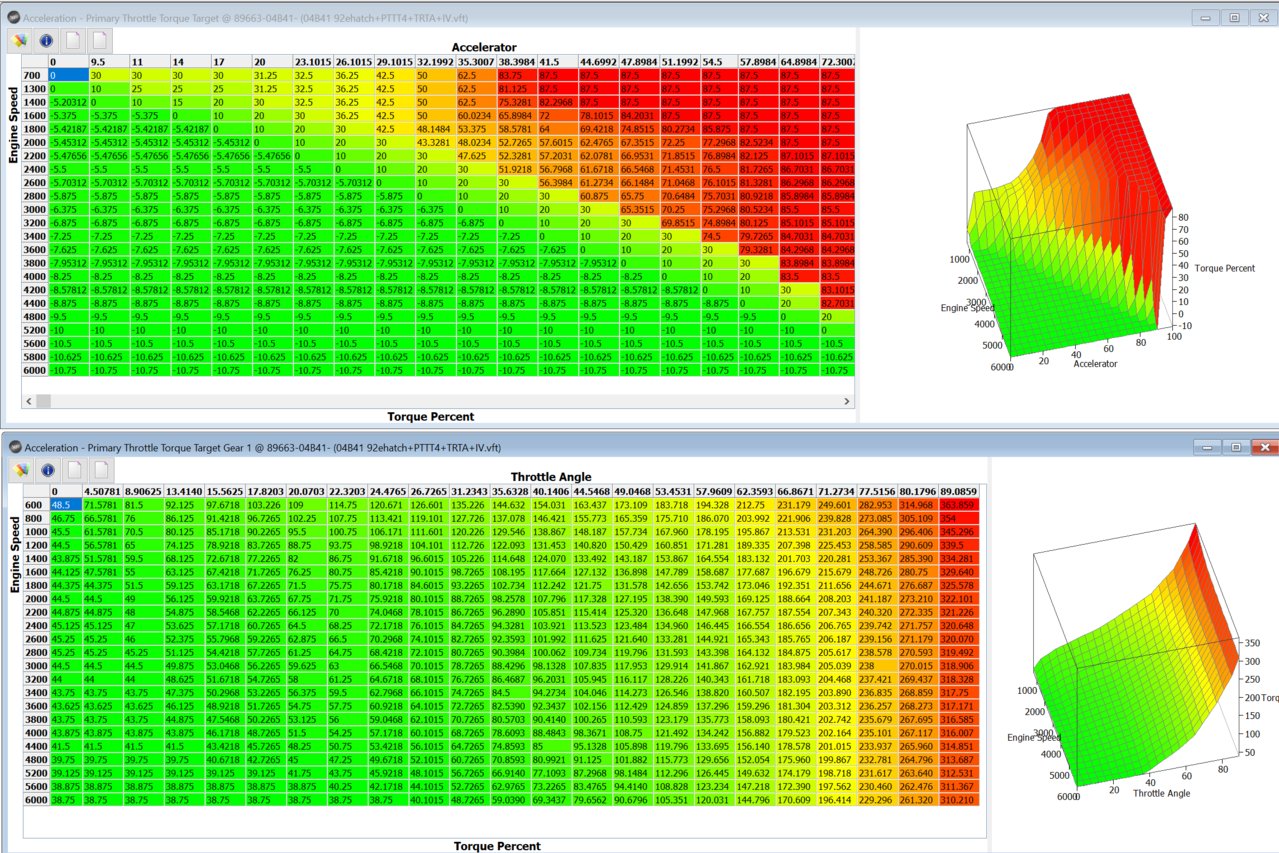

    I have been playing with the first gear throttle map again.
    The 2.0 file from OVtune is too aggressive. There is no throttle modulation for cruising and such. Everything is "accelerate accelerate"
    My last file was pretty good, but still mostly "accelerate"
    I dont always want to go full tilt when taking off, and like the lower throttle to be less aggressive.
    Im currently on a map that does this, but feels fairly dead in the mid throttle range. low pedal is good, high pedal is aggressive (if you bury it from 2k rpm in first it will spin) but the middle range is basically the same as the low range.
    Ill update when i find the money.

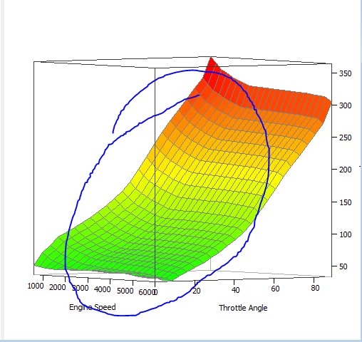

    Is that the PTTTG1 map? And by cruising, do you mean maintaining cruising speed or cruise control?
    I ask because I've been trying to find something that goes decently well from a standstill all the way through the ranges (like you) and have been struggling with what is likely the same problem. Going from a standstill now (using your collaborative efforts on a stock file) is leaps and bounds better than the stock tune but I find it's a bit dead for power in the 1-2k RPM range (doesn't matter which gear really).
    I'm wondering if this crater shape is it? Based on my maths knowledge, I would figure given the three variables the crater shape is neutering it some?
    I probably should wait for your response but I've been pondering these things (and others) for awhile now but haven't had the time to look into or test anything.Capture.jpg

    this is what i have now. note i swapped to Regular fuel and this is based off REG SFOB now. (not that it matters)
    I played with the throttle stuff a lot. I have ran with the primary table at all 0s and various other numbers and have come to the conclusion that it is more of a gain thing. A pedal commander if you will.
    I put the factory one back in, and modified only a few numbers. It seems to be divided into an acceleration portion (diagonally top left to bottom right) and a cruising/deceleration.
    The first gear map (the only one we have in 2.0 due to the throttle patch) is the biggest, most important changes to make. It is sensitive...very sensitive.

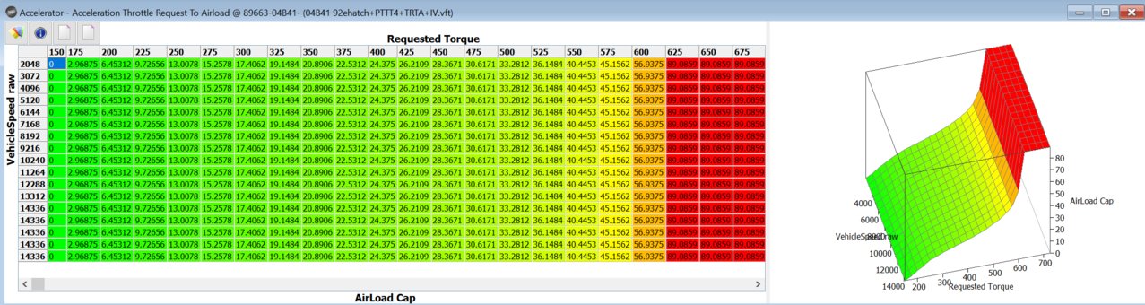

    I took the factory first gear map (slow slow slow by itself) and put it in, i copied over the max values from 2.0 FOB to the far right column and started smoothing into the factory lower end. I have tried 4 different ones, each time pulling my CTRL I lower into the throttle band.
    The ATRTA file, i made it all the same, but not linear. I dont want it to be different based on speed, but the linear one just seemed to act funny to me, a lot more rev hang? not sure.

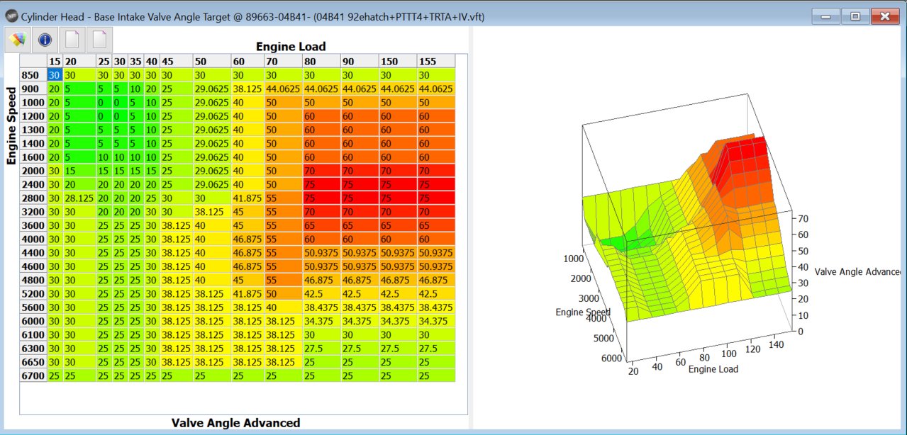

    The last one is the intake valves, you must update to the new version of VF for this to apply as the scaling is different. I feel that one of the largest causes for the laggy/steppy throttle has been the constant changes to VVT as you move from low to high load.
    Anyway, this file has been fairly good if you ask me, but it is way different from 2.0 and will feel sluggish at first, until you realize you have to push the pedal to get the throttle.

    Here ya go. The primary throttle is what im playing with now. the very first one in the map. which is different from what i posted earlier. I drove around with it for about 60 miles today with the wife and she even commented that it felt good (rare)
    i did get one instance of a stumble around 2k rpm but i went from on throttle, to off throttle, back to on throttle due to another driver not driving well.
