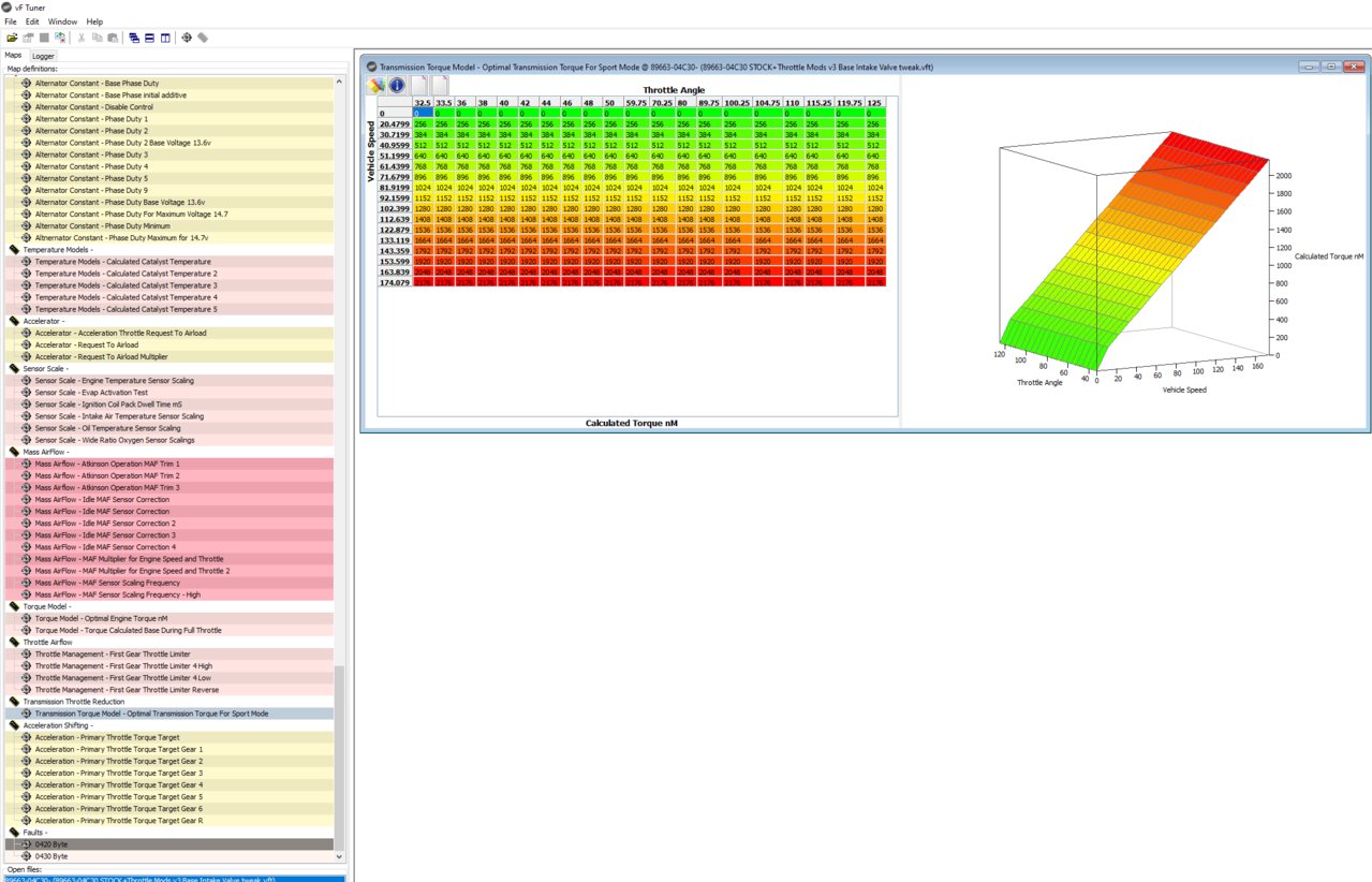

    Do you have any idea what the Transmission Throttle Reduction (Trans. Torque Model - Optimal T. Torque for Sport Mode) does? I infer by the name what it does but what I mean to ask more is how much it affects what we're doing?
    Edit: Or how about the Torque Models? We have an idea about the Torque Calculated... as we bump it to 5000 and such but how about the Optimal Engine Torque (nM)?
    I can't help but wonder if some of our changes are being muted some by these?

    i posted some logs and ovtune had me send them the file, he came back and said i was being throttle limited by the torque calculated and suggested i raise them.. he did not say to what. so i raised them to 5000.
    honestly, i do not feel a difference between the 4k and 5k change. but it didnt seem to do anything negative, so i left it.
    As for the transmission throttle and sport mode...we dont have a sport mode, so i have no idea.

    How do you not have it? Is it new for my ECU perhaps? Here's a screencap. Stock settingsCapture.jpg

    I have i t, actually i have 3 maps under that category, but our trucks dont have a sport mode...not sure what it does.

    Okay, I get what you mean. Interesting that you have more maps there; I wonder if that's in part due to the maps available to me are 'underdeveloped' as it were (likely there will be more as Mat has more time with this ECU; I still don't have the tune pack (not created yet))
    And yeah, my truck is a 'Sport' model but that has nothing to do with this. What is Sport Mode? I guess we have a while to find out yet...

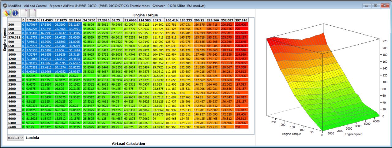

    Has anyone tried smoothing out the Airloads (like with Ctrl+I or similar) for the jerkiness and neutered power in that 800-2k band? something like this?
    I think perhaps I did and that's what gave me Limp but I can't remember and I won't be able to test until this evening (when I'm off work and there's not many cars about)

    You don't want to do that. It will most likely had a lot of jerkiness.

    hmm, that's very contrary to how I think it should work. You're probably right. I would have thought more linear, or even a gradual curve depending on preferences, on tables such as these and the rest would yield the desired result but I suppose not.

    I agree, but this map is most likely built off of dyno data that relates MAF sensor data to create faux-MAP data. So, I can see this being non-linear due to how the air flows around the throttle plate and toward the valves. Basically accounting for all flow and pressure changes between the MAF sensor through to the intake valves.
    I over-tweaked these on my V1 ALC map edits and paid the price.
