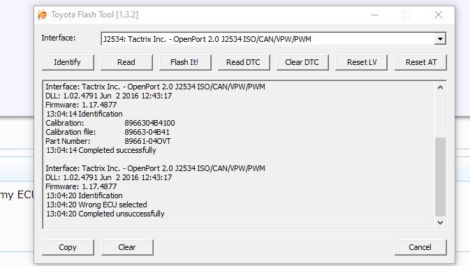

    Still jumping into my VFTuner shoes... Sorry still trying to process the 452 thread. I purchased the base VF Tuner which came with the stock tunes. Near as I can tell my ECU is 04B41 but when I try to read it it tells me wrong ECU selected. Any reason why this would occur?

    Why are you trying to read it?
    Edit: looks like there is already an older tune flashed, which is read locked which will cause the reads to fail.

    I thooought I had to read it for the maps to be editable. For some reason I thought the map editing is a real time function to work. Still learning!

    you are in 04b41 - make sure that is the one you spend credits on. not 04b40
