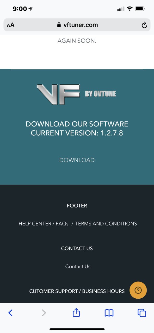

    Hey guys. I'm sure this has been covered in depth in multiple places but I'm having trouble finding any info. I had purchased OVtune back in the day with the dongle-less set up and used Toyota Flash Manager and the P5flash utility. What do I have to do to flash new tunes to my truck now? I haven't been keeping up with the whole transition over to VFtuner so everything is completely different from what I remember.
