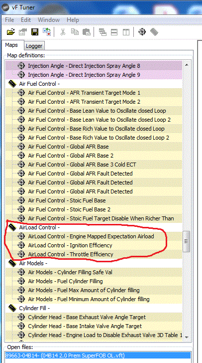

    has anyone messed with these tables yet? Mapped Expectation Airload is an interesting map. may ctrl-I the other two at some point to try.

    Not yet here. I've been dragging my feet.
