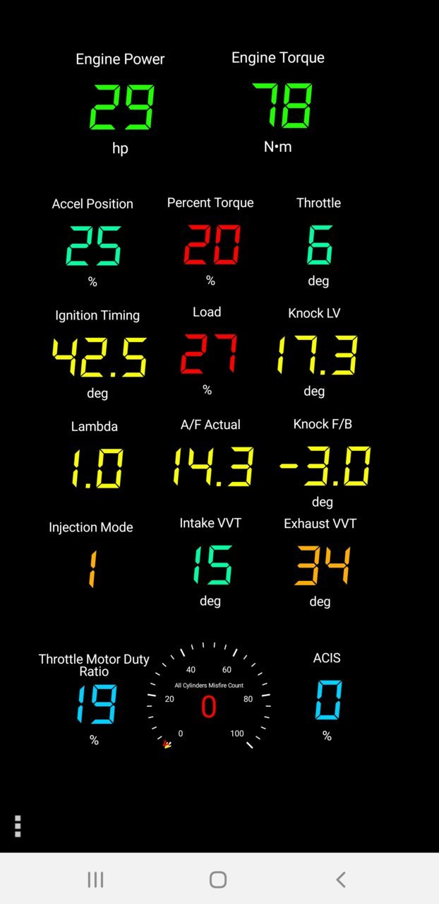

    Well, here is the first run with obdfusion
    It's 87 octane reg file with 89 octane fuel.
    No modifications other than the maps i showed previously and some acis
    At first the knock correction learned value was around 22. And the feedback typically around -3, which i see is about normal.
    When i found a spot that took a bit more throttle in the 2500rpm range, load of about 60 to 70% the knock feedback went between -5 and -7 and the learned value dropped to 17.
    From what i understand a knock feedback value of -7 is not ideal
    Interesting note, which i think it's more related to the ignition and throttle efficiency tables, you can apply light throttle and the throttle angles won't change from 0, but the ignition will advance. I suppose that is where it chooses the most efficient way to increase torque and will add timing rather than throttle to give the demand for torque you are after.
    I wonder if that could be the key to the lumpy feeling.
