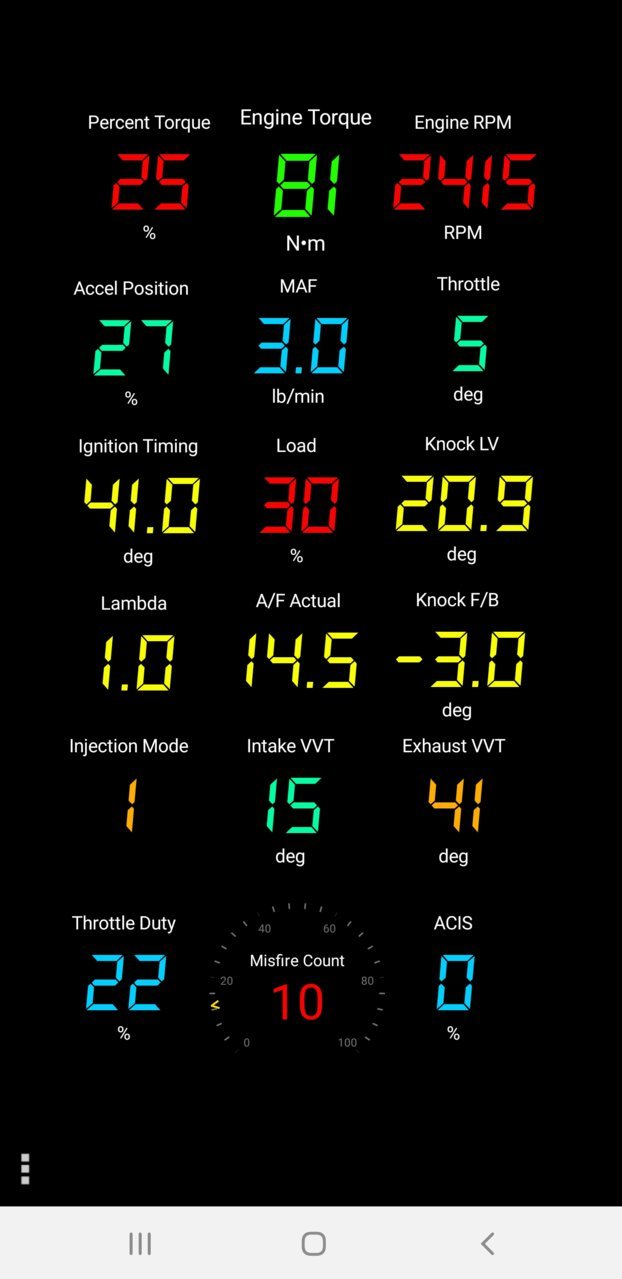

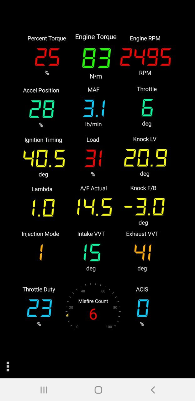

    This is what I'm currently trying to get rid of.
    I'm logging some misfires low in the rpm.
    I'm also seeing pretty high knock feedback during medium to medium high load between 2 and 3k rpms.
    I may have helped my misfires, i drove almost 150 miles yesterday while only logging 1 and i didn't feel it, so that's looking up so far.
    I changed the afr target in the lower rpm and load range to 14.5 rather than 14.7- will have to monitor fuel mileage but got 19 with mixed driving yesterday.
    Currently I'm still running my ptttg1 map -gives range back to the throttle
    I have a different pttt map- lost some engine braking but I'm not sure how
    Atrta is increased, as it was throttle limiting me (attempt to mitigate rev hang)
    The throttle and ignition efficiency maps are edited to target more throttle and less ignition timing.
    And I've pulled a few degrees of timing in the problem areas from the low knock tables. - was seeing feedback up to -7, yesterday max was -5
    By the end of the weekend i should have some different maps to share that you can try and see if it helps with some of this.

    Are yours this bad?
    They are always at the same load and rpm range. I may have to load up Matt's file and stock to see if they present there. I have been feeling this stuff since i bought the truck, so I'm pretty sure it will be present in all files.

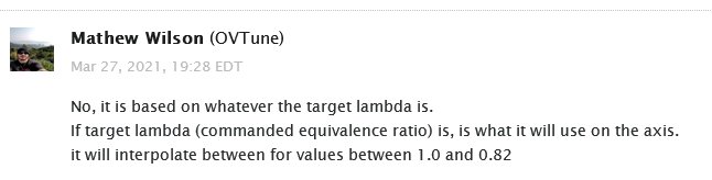

    @OVTune Just outta curiosity, the 4D ALC table (throttle and ignition). Is the 0.8 lambda table for the Atkinson and the 0.9 lambda table for the Otto cycle?

    Matt's response.

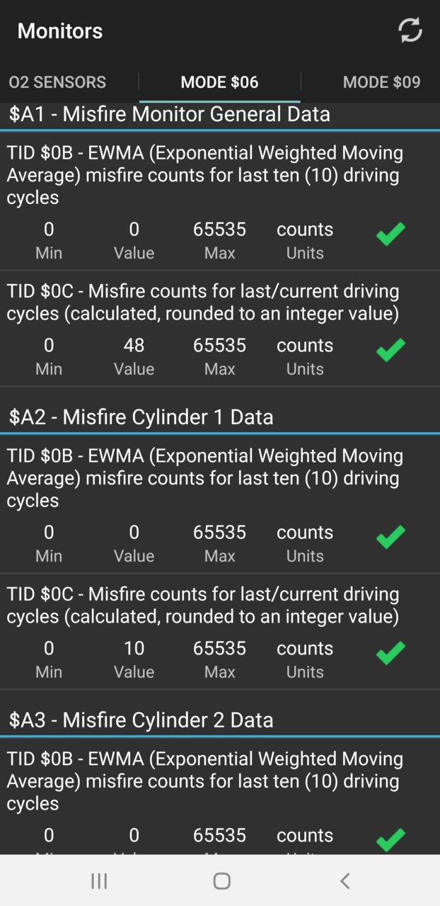

    Not sure that bad, but I forgot to include misfires for logging so I will have to do that again tonight

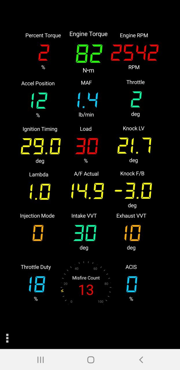

    I only notice them when transitioning from off throttle to on throttle. and its always a low load/low rpm misfire. I am not constantly watching my phone, but when it happens i feel like i'm running over rumble strips, ill then look and see the number climbing.
    If i back off the throttle they will stop.
    If i try to accelerate during one of those events, then the truck will buck. In second gear it bucks so hard i have to let off the throttle. In the other gears it just lumps a bit.

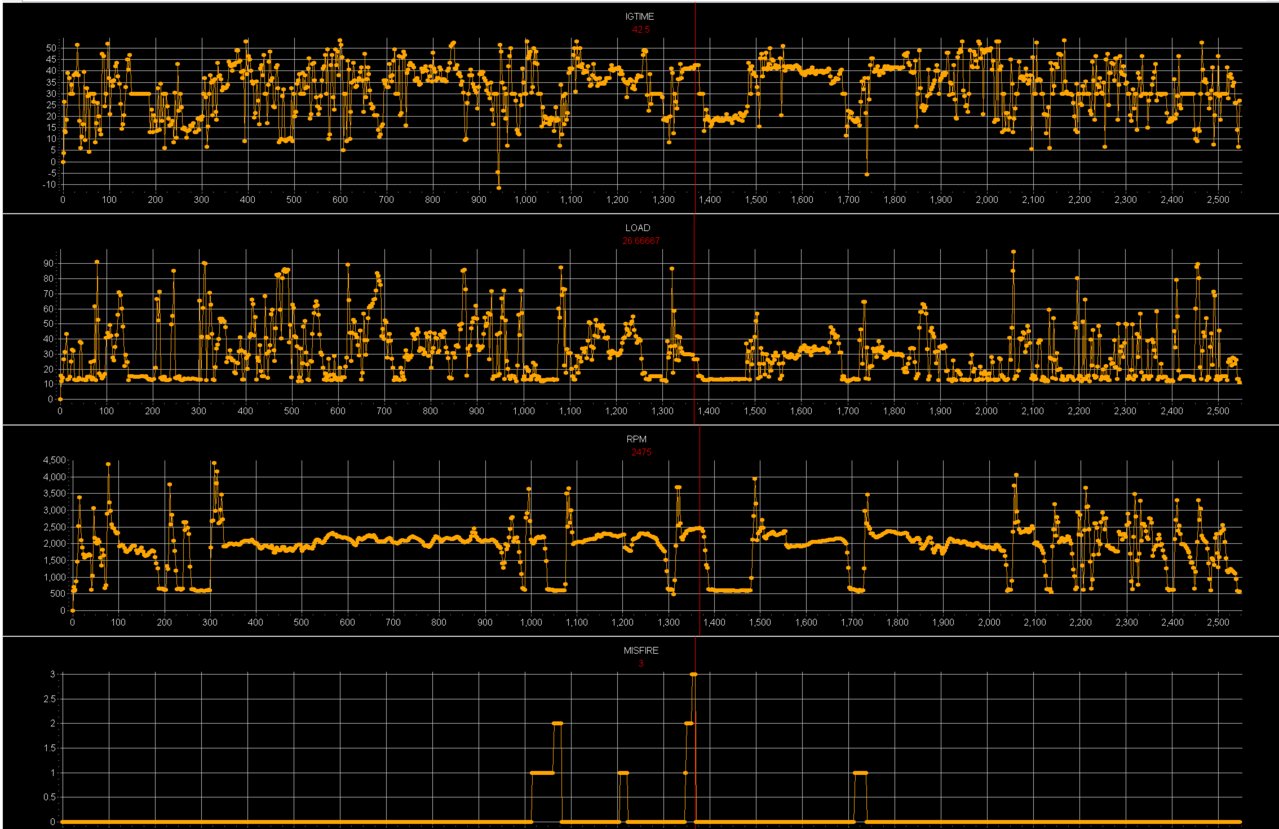

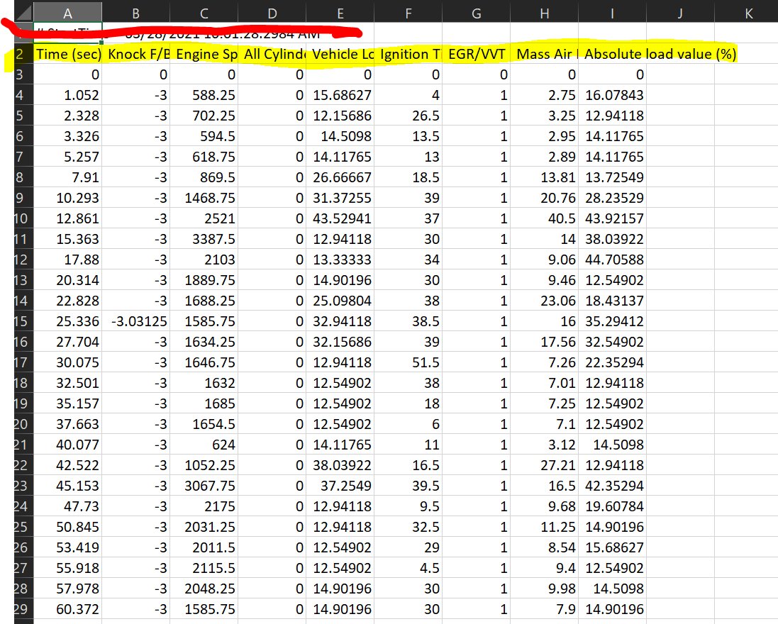

    Gonna show you guys how to take the logs from OBD Fusion and use VF Log reader to view them.
    First you have to setup the Logger in OBD fusion.
    Under Settings>Logging>Select Items To Log
    Deselect anything you dont want (GPS, SPEED, ETC)
    Select the PIDs you want (The same ones from your dashboard)
    It will log every drive automatically.
    To access the logs, click on LOGS>Scroll to FILES
    Find the file you want and choose "SHARE"
    Email them to yourself.

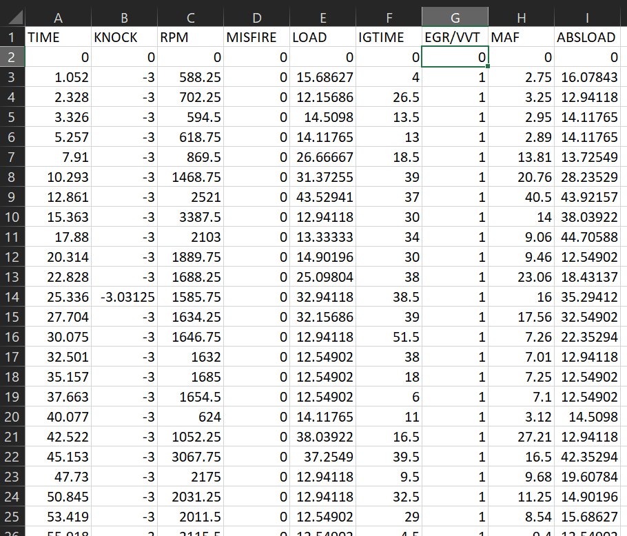

    Next you need to edit the CSV in excel (if you don't have office you can use the online version for free but it is a little of a pain since you have to open it from there, then save as a copy to your desktop)
    Once you open it, delete the top row and shift rows up (the red line) Pic 1
    Then rename the top columns to eliminate any spaces. (highlighted yellow) Pic 1
    The result below:

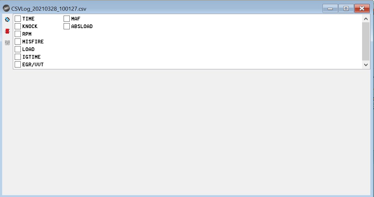

    Now open it in VF with the CTRL+P or File>open>openCSV
    Now you can view logs of the stuff that Matt hasn't added to VF tuner yet.

    Doing this allowed me to view when and where the misfires are happening. If you notice in that drive (42mins) that i only logged a few. Looking at the logs from the last two days (over 300 miles) i only get misfires at 30% load and 2000-2200 rpm and at idle.
    The idle misfires i don't feel, or even care about, and as far as i know either aren't real or are not very important. However, the ones at load i can feel,
    I'm pretty sure these are only happening in the early EGR stages (EGR is done through valve timing rather than an EGR valve, I think this is the range in the exhaust valve timing where they are advanced and it starts around 30% load and 2k rpm)
    If I stay out of that load range, I get no/minimal misfires, if I cruise in that range (4th gear around 45 mph on a road I travel daily) then I get misfires that just keep counting up, I can hold it there and they just keep going.
