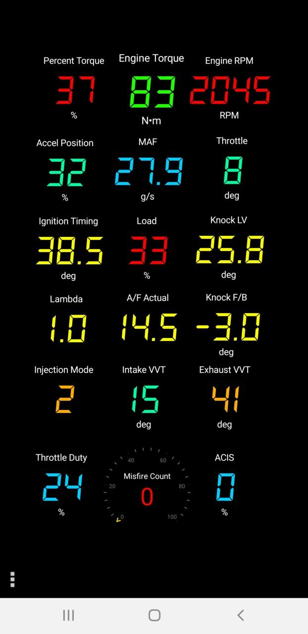

    So i actually have gotten mine to where it is extremely smooth by adjusting the low knock tables in the ranges that were reporting feedback of around -7
    In the morning driving to work when it was cool, it drove great and was giving me a Knock Learn value of around 22-23
    In the afternoon when it got over 70 degrees outside my knock feedback under load would tank to -6 -7 and by the time i got home my Learned value was around 16 or 17 (pathetic really)
    I could really feel those knock events as a stumble/tugging/lunging feeling.
    So after logging a LOT this weekend, and driving in various conditions, im to the point where it felt good in both weather conditions for 2 days straight.
    Today (pictured below) is the highest knock learn value i've had. It varied between 22 and 25 and the highest knock feedback i got was a -5 under heavy load at 1900 rpm in 6th gear (lugging the motor)
    I feel that the truck was always trying to run at the most aggressive timing it could, and it felt good when it could do that, but on the days it couldn't, it was a piece of crap.
    Now it is almost never hitting a -5 or more and almost always at -3 or even -1 and i saw 0 at one point, meaning its adding timing since it has not hit knock. It gives a feel of smooth acceleration, rather than always pulling back.
    The last two days have been the smoothest running, and closest to a cable throttle i've had yet. That's why i wanted volunteers to test and see how it handles different conditions.
    Obviously warmer weather is to come, and i will have to continue to test and log but it felt damn good, and im sure there is more to be had from this.
    Also, in my previous edits, it was throttle limited (maxing at 70-80% load), and any attempt to increase that caused me rev hang. Now im able to hit 98% load and haven't had any major increases in rev hang (at least no more than was previously there) I have a theory on why this happens more in certain conditions.
