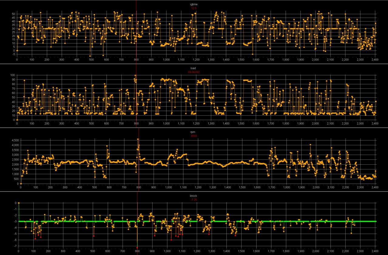

    @Mooseditty17
    Here is a shot with a spike to -7, matches with the High knock table rpm, load, igtime.
    I also have some spots hitting -6 that match up with the base map. Matt said it will either advance until it hits knock, or the base map. The base map has a retard map as well, but in the low load areas the retard is 0 all across.
    in that instance it had 37% load @ 3k rpm and 37 degrees of advance - matches the base file perfectly as both the low and high knock tables are above 37 and it matched up perfectly with the base map.
    This shot is from today, went from around 1k feet to 1800 feet, 82 degrees ambient temp, knock learn started at 24, went down to 17 and back up around 23 for the rest of the trip. Still really smooth but temperature affects it a lot, more than anything.
    I dont want to eliminate all knock retard, obviously i want it to be able to advance and produce maximum power given the conditions, but what i was seeing before was the truck constantly advancing as far as possible and having to throttle back constantly.
    Id rather have it in the "sweet spot" more and have less adjustments.
    C41n and Mooseditty17 like this.

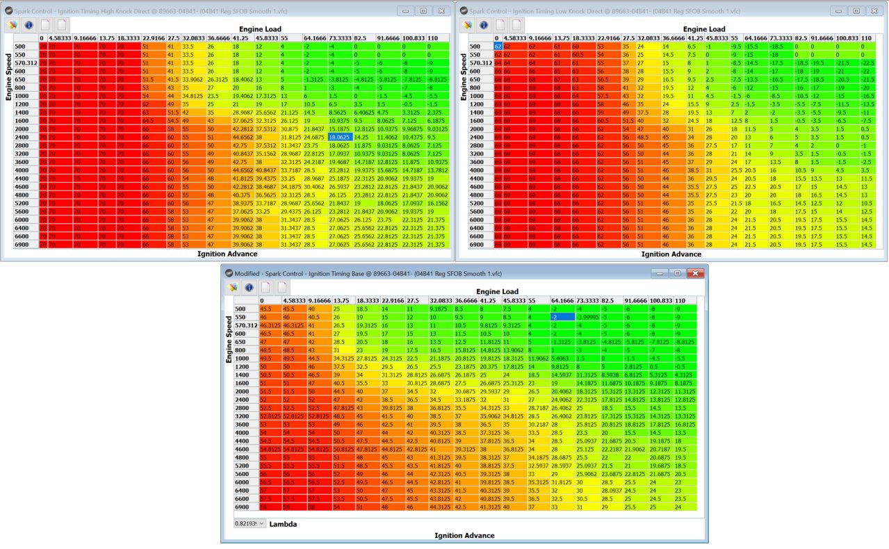

    Here are the comparisons between my edits i'm currently running and the base timing with the base retard added to it through excel and copied into the file (i did not save that, just wanted to compare the three maps)
    The base timing after base retard = higher than high knock tables at higher load and rpm but = lower than low and high knock tables and low load and any rpm and = around the same for the middle ground.
    If one were to try and make timing advance a "narrower" window, it appears that we would need to play with all of these, making the base map our upper limit (which it currently is looking at the way the tables compare)
    unless im way off base <-------pun lol
    @OVTune
