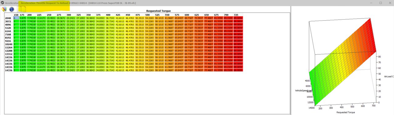

    Yes. The edits here create an ultra-linear throttle. For me, I absolutely enjoyed it.
    @92ehatch . Can you look at the throttle map that @houser1995 is talking about? Do we need to edit the post?

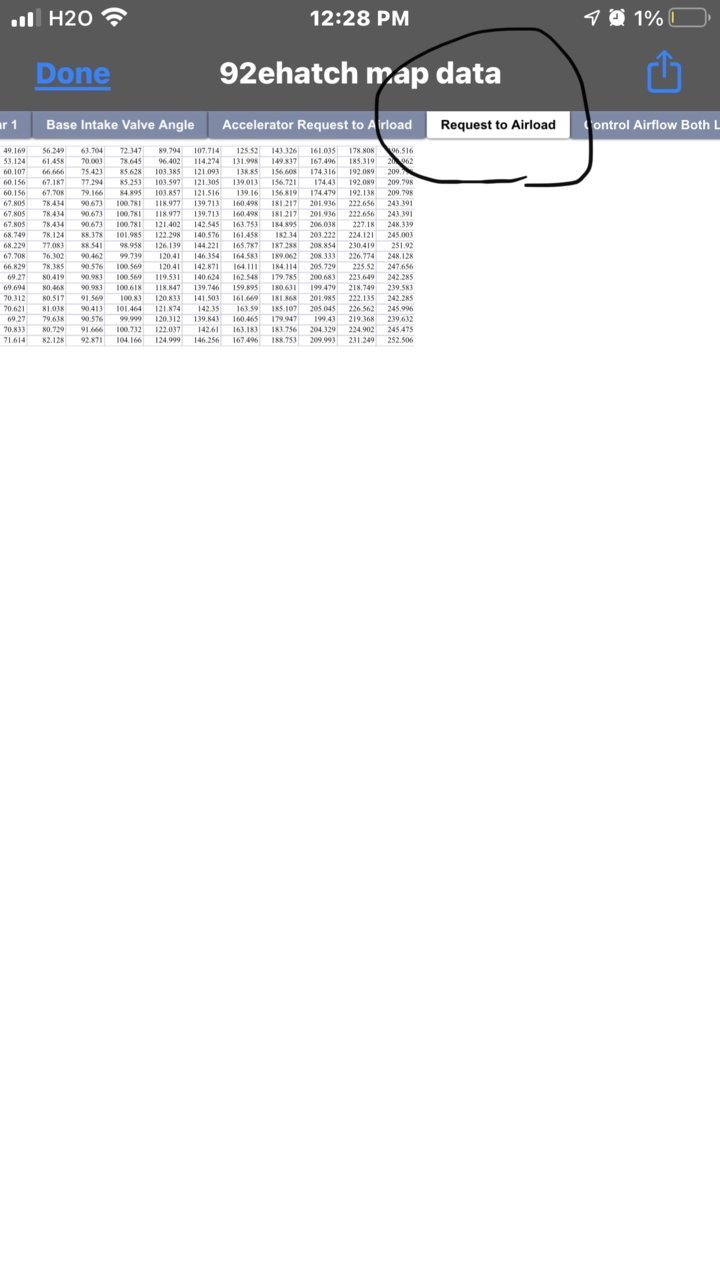

    Before you investigate hatches tables let me see if b13 and b14 have different matrix values or some difference between tunes that would cause those values to be changed upon saving. When pasting the values all is correct. The 3D map doesn’t change for me when I paste an entire table so the only way for me to see the new 3D table is to close/save the table and re-open it. And everytime I do that I get the same result that is pictured in my post. Those values in the picture are not even relatively close to the values hatch has in his table. So my guess is that vf is trying to “correct” that table because of another table that affects it. I have no idea how accurate that is but that is my theory. I will check into this tonight. Compare tables between b13 and b14

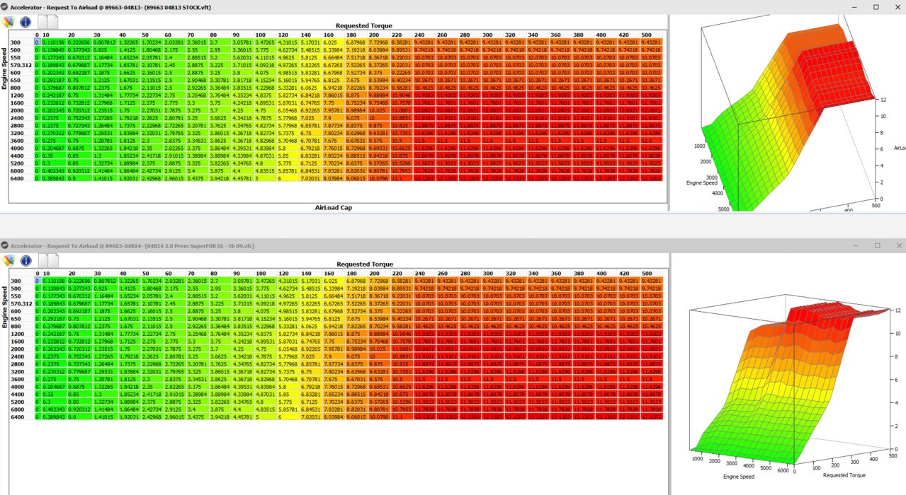

    I just checked 04B13 and 04B14. They are the same Stock and Tuned:
    The question that I have is that we never edited that map. Accelerator - Request to Airload. Our edits were typically to Accelerator - Acceleration Throttle Request to Airload (ATRA):
    Can you check which map was being discussed versus Accelerator - Request to Airload you edited?

    I had no edits to the request to air load table. Only the throttle request to airload table.

    Looking at the screen shots, you pasted to the wrong map. See tonereds post

    Ahhh well I am sorry for the confusion @tonered @92ehatch
    I am sorry I haven’t got back to you sooner guys, been extremely busy this past week. But I saw the request to airload tab in the 92ehatch spreadsheet next to accelerator request to airload and thought it was that map “Request to airload” under the accelerator section. The map right under the ATRA

    Ahhh well I am sorry for the confusion @tonered @92ehatch I saw the request to airload in the spreadsheet next to accelerator request to airload and thought that it was the right map.
    So in the past couple weeks I’ve updated to 04b14 and updated vf to 1.5. And upon experimenting I figured that table for sure shouldn’t be in there @92ehatch. I do see what you were doing with it though. If you paste the values from that request to airload table you made into vf in the request to airload map and click on the upper left column and press enter so that the 3D map updates I see that it smooths out a lot of the dips and such. But after you exit out of that map and save the changes it goes crazy and tries to correct it. The values do actually smooth the map but they apparently are too low/high and vf butchers the entire thing when trying to use them. So anybody using the table that @92ehatch made DO NOT use the request to airload table. All other tables are just fine, actually they are phenomenal. Good work @92ehatch and thank you for sharing it!

    At any rate, i've significantly reduced the maps that i have edited and pretty much stuck to Primary throttle changes and acceleration throttle request to airload. I did like the changes to the intake valves, but noticed a drop in MPG (if that matters)
