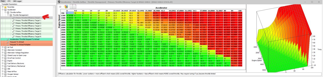

    I just updated and found all of the throttle tables and the throttle and ignition efficiency tables.
    The throttle ones were easy, the other two were more difficult

    Weird I actually found the ignition efficiency tables quickly and easily. It’s the damn ptet and ptetg1 tables that are being elusive

    Here's the new spot for PTET. Those are also the Per Gear maps below it. Note that for the MT, only PTET1G is active in the 2.0 Tunes. All gears use that map.
    houser1995[QUOTED] likes this.
