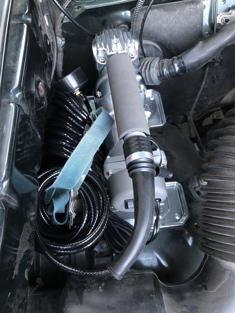

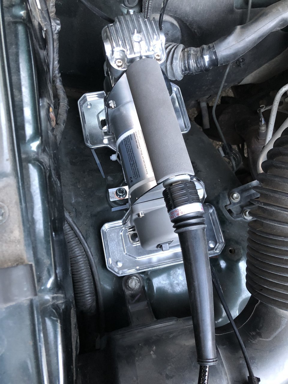

    Done. found a nylon barrel spacer that i threaded and stuck on the single post and then used to bolt down the front of the tray. then used a piece of alum stock for a strap. $10 / 1 hour - done. thanks for the suggestions....

    Need more pics on how you made the mount lol

    How's this holding up against rust, heat, and the elements? I was thinking of doing this for the same reasons.
