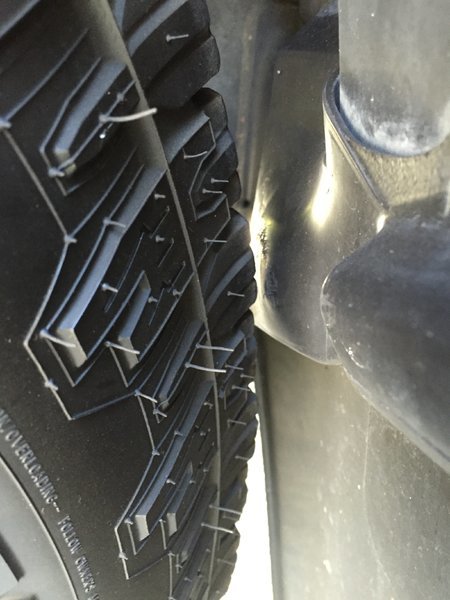

    Posted my reply to Unchained before I read your post, I figured such. I may have another excuse for 887 coils and since we're all here, lets chat about that....:D
    Running with 885/billy 5100 front, Dakar/billy 5100 rear without the d29xl AAL.
    SCS 16X8 SR8 with 265/75/16 Toyo Open Country AT II
    At full lock I rub here, you can see where the mud flap is roughed up. Curiously, I'm only rubbing on the drivers side and I wonder if it's because I never put the Taco lean spacer in when I lifted it? Any thoughts on that, go ahead someone say it...remove the flap or trim it. I know that, lol. I'm just wondering if it's because I never used the spacer.

    Wow I have never had any rubbing at all with 265/75/16's on TRD Beadlock wheels

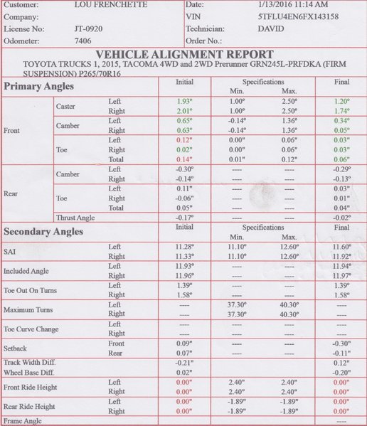

    Stock or aftermarket UCA's and did you get it aligned? And if so lets see the specs
