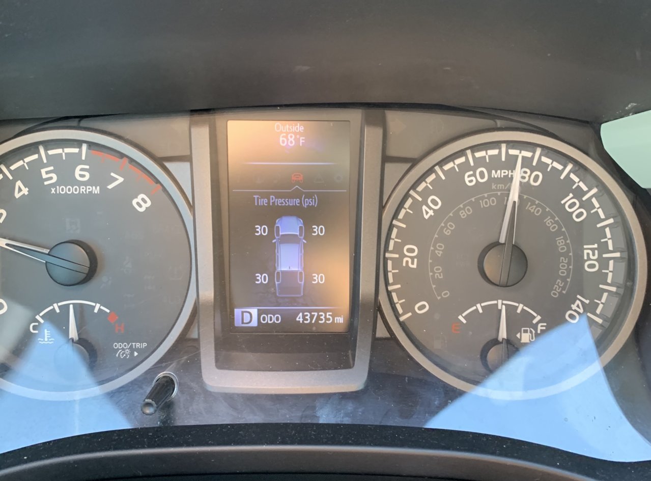

    Hi Everyone... sorry for the delay as I'm now more puzzled than ever and didn't really want to cause confusion for all... but I guess I don't have any answers or clue as far as what's going on. I can only share with you what happened after I got my vehicle from Toyota on Wednesday PM:
    Timeline:
    Got the truck. No vibration in the seats, no vibration in the steering wheel at various speeds. After 20 miles I noticed a slight vibration while braking "In the steering wheel".
    Informed Toyota and they said that's probably the rotors and need to be checked.
    Next morning, while driving the truck to work as soon as I reached 55-60mph I noticed steering vibration is present while cruising. I applied brakes and there was vibration in the steering wheel which was even worst than before...(unfortunately TW doesn't let me upload .mov files or I would have uploaded the video)
    Going back home, truck drives perfectly smooth without any vibration. After about 20 miles I noticed slight vibration while braking on flat/downhill at cruising speeds with mild brake applied.
    Waiting for another appointment to check the rotors I guess...
    Tried reducing the air pressure to 30psi without any luck. Just more tension on the steering wheel.
    I have no clue what's going on....
    One thing that I noticed is that the I try to turn the steering, it feels as it's in 4wd or a similar feeling maybe. This is at higher speeds of course and not at a full turn. Just enough pressure on the steering wheel to slightly change the direction of the vehicle. I can feel a pulsing resistance if when the steering isn't shaking.
    I have no idea...
