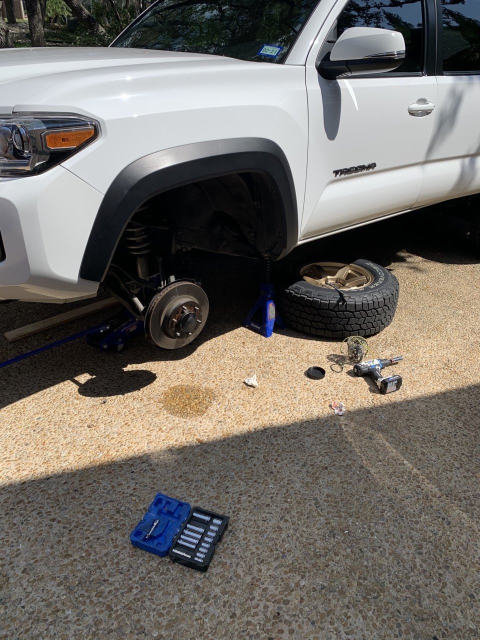

    Damn rotors are giving me a hard time.
    Off to buy some removal bolts.
    I’ll have this done in a few hours.

    Rotors turned and new Wagner pads made for a smooth ride. What are the odds?
    So yeah, it smoothed right out.
    First time Ive had to turn rotors at 44k miles.
    Fresh rotors look nice!
    They popped off easy with M8 1.25 removal bolts
