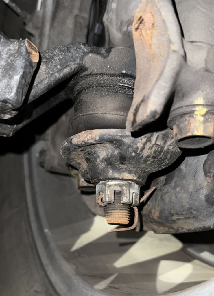

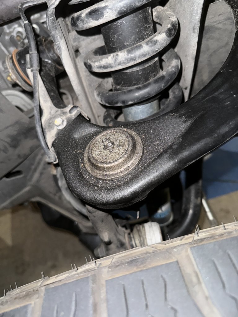

    this question had probably been asked many times but i have vibrations on a 2007 Tacoma prerunner with a i believe 1 inch lift on b8 5100 ride adjustable front coil overs and 5100 rears on a 1 inch spacer and regarding the loose steering i have checked components im pretty sure its just my tie rods but theres also something leaking out the top of the UCA ball joints and there is one LCA balljoint thats leaking too which is the attached image (i forgot to take picture of the UCA but the area around the ball joint is wet/greasy only on the top of the arm)

    The pictured LBJ looks in perfect condition. I would check tierods.
    Also, you did not specify when you have a vibration. There are too many factors to figure that out just yet. Need more details

    Here’s what my upper control arms look like
