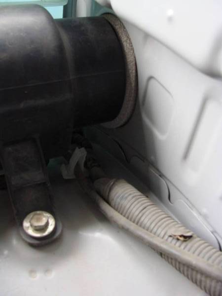

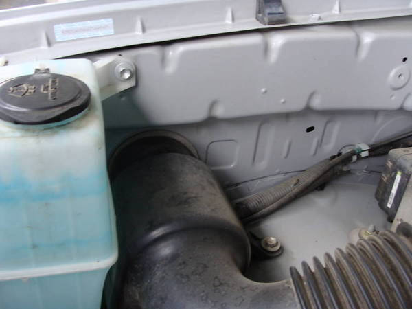

    I have an 06 too and noticed it had some foam wrapped around the end of the snorkel ( part that inserts into the fender). It would be the easiest fix to just get some foam weatherstripping and just wrap it around where the tube meets the fender. :)

    Just around the tube where it inserts into the hole in the fender. The rattle comes from that plastic tube hitting up against the hole in the fender that it goes into.

    Here's a couple of pics. I ran out and snapped of it. Hope this helps. :)
