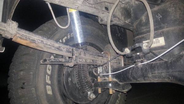

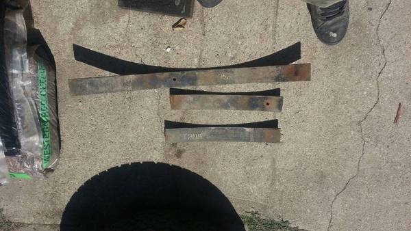

    Traded the 2015 TRD Pro 6spd Supercharged on a PowerWagon and could not be happier. My 2011 Tacoma with the TX Baja package (Added by me) is still treating me great. My 1985 Toyota never skips a beat.
    I know others have done the carrier bearing spacer etc, but personally every one of my tacoma's have had the issue fixed with AAL, a replacement spring pack would be better but it costs more as well and AAL can be just fine.
    2008, 2012, 2013 and my mothers 2011 have had the same issue, the only one that i didn't fix was the 2012 and its because i got rid of it.
    This is the AAL that i have in my 2013 and it fixed the problem for me, its also better than the other brands i have used in the past and cheaper so win-win.
    http://www.ebay.com/itm/1995-2011-T...fits=Model:Tacoma&hash=item3a6e43d757&vxp=mtr
    make sure if you buy one, to get a "long" or "soft ride" short add-a-leaves are just junk. I like the brand above because the price is the best and so far so is the part vs fabtech, rough country and some others i have had in the past.
    this is the above linked AAL in my truck
    this is whats left of the Fabtech one that was more expensive

    So when you put the AAL in that you got does it raise the rear up any? Do you need to change anything else out? How long did it take you to put in?

    yes it makes the rear taller, it takes me about 45 minutes but i have done it many times.. 2 hours is probably a pretty fair estimate for normal conditions just be sure to do one side at a time, if you pull both sides you will have to wrestle the axel. And watch you rear brake lines on the drivers side if you drop the axel too far you can mess them up.
    It raised mine about 2 inches which matches the front perfect with my preloaded baja package fronts that are almost exactly 3 inches lifted

    unfortunately i dont know of any replacement packs that won't add some amount of lift. The TSB springs would add a little as well but its not something that you really have to lift the truck for. In the for sale section on here there are TSB springs from time to time.
    You could look into a traction bar or something, but i dont know of any that are out there for the tacoma stock.
