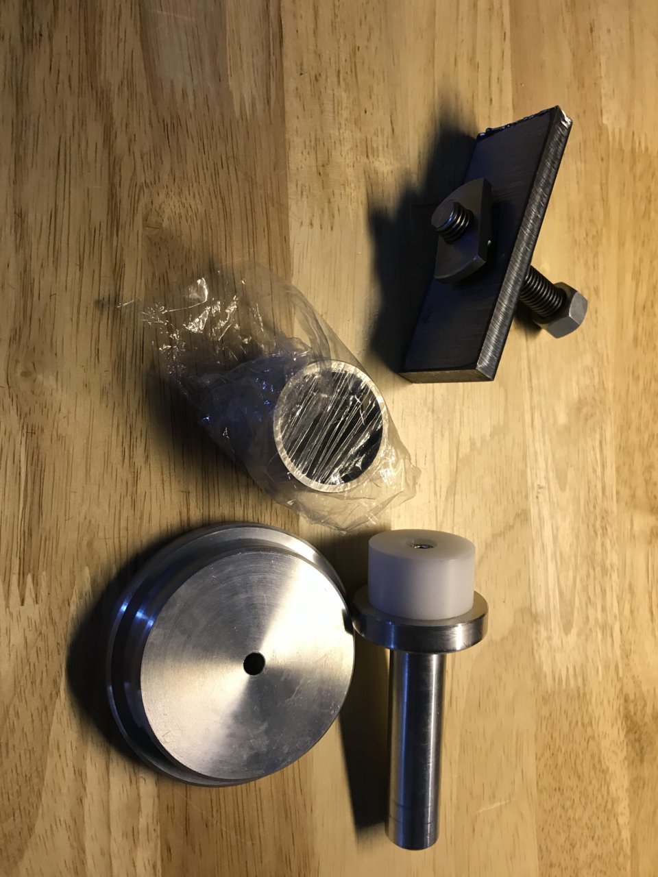

    I was about to take my truck in to Pat’s Driveline in Calgary to have it scanned for the low speed vibration and they said it’ll take 3 hours, $300 and I would have the report. For me $300 is a business write off and you have to consider what your sanity is worth. You can have a report in your hand in 3 hours or visit the dealership a half dozen times or more and listen to them tell you they can’t duplicate the problem or that there’s no TSB or maybe they change something and you still have the issue etc, etc.
    gearcruncher and shakerhood like this.

    I got the kit on stand by, Justin Case.
    TacomaBeast67 likes this.
