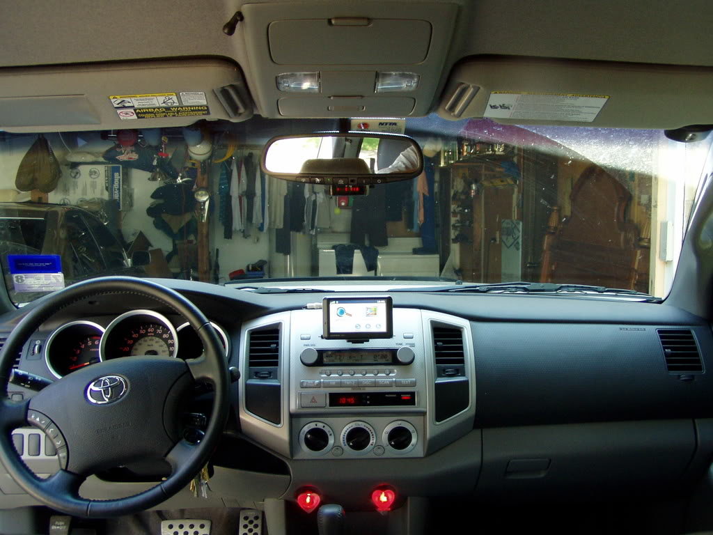

    I hardwired mine with an "add a fuse". I just drilled a small hole behind the gps for the power and the aux input to my stero.

    Excellent, that's what I was looking for.
    Wormhole7, can I get a side picture of your mounting? I'm interested in knowing if you just used the sticky pad against the deck or found something I'm not aware of.
    As I said, my original idea was to have the power cable come out where the dash and the windshield meet, but I might just mimic Wormhole7's idea - the stereo needs to come back out soon to hook up the amps, anyway.

    I did use a sticky pad disc and just put it right above the cd slot.
    I have had no problems with it so far and it's been there for about 6 months.
    I am considering using a dremel and cutting a slot above the cd and mounting
    an arm inside. I'll be sure and take pics when I get around to it. I did buy an extra complete radio with dash from someon on this site so that If I screw up, I'll have an extra to put it back to stock.
