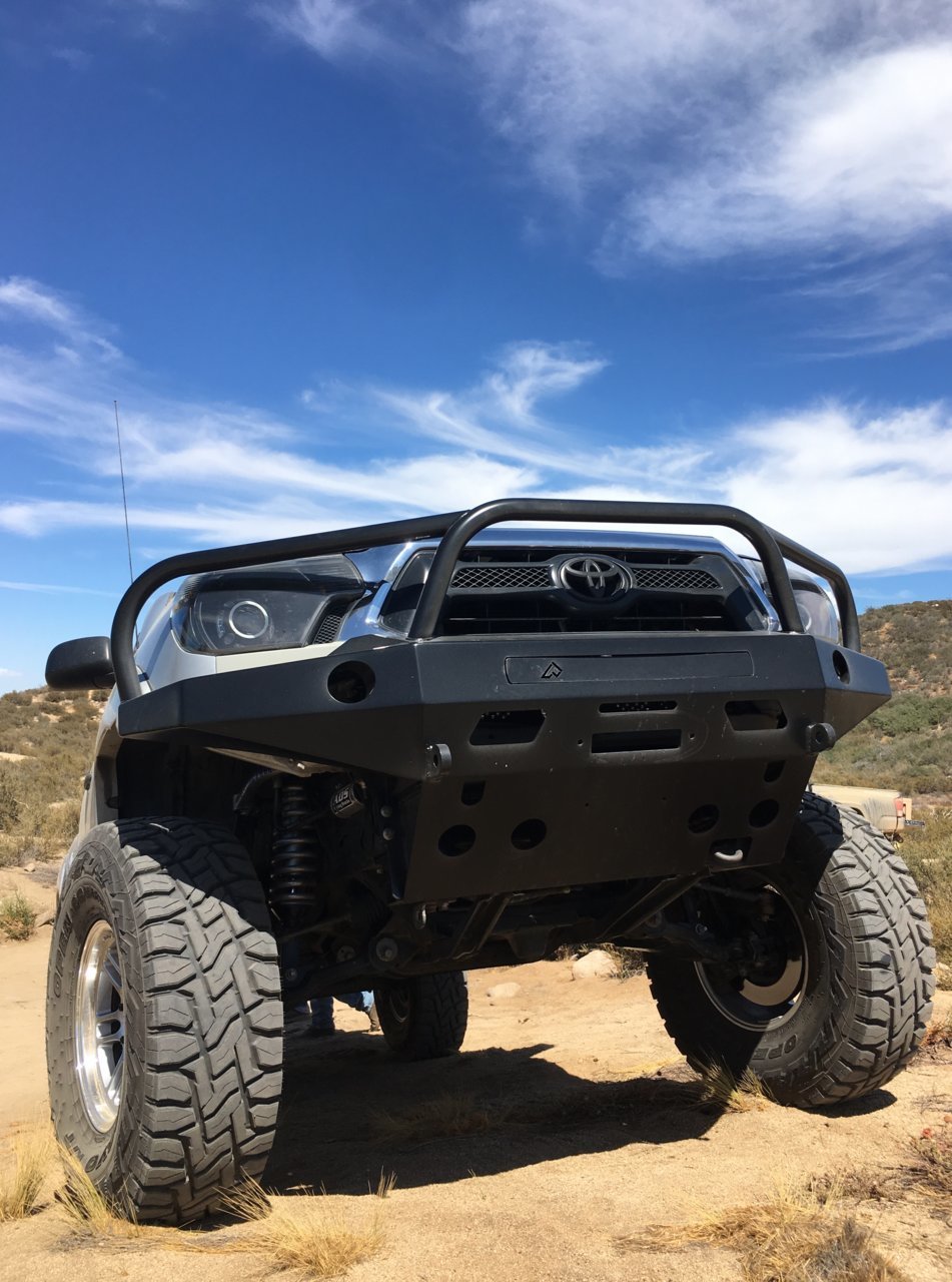

    Truck Spec:
    Year:
    2007
    Model: Tacoma SR5 ACLB, V6 Automatic, PreRunner
    Color: Silver
    Miles: 260,000
    Mods:
    Exterior:
    Wheels & Tires:
    • Mickey Thompson Classic III - Black / 16x8 (Removed)
    • Enkei RPT-1 - Silver w/ Polish Lip / 16x8 (Current)
    • BFG Ko2's 285/75-R16 (removed)
    • Toyo Tires Open Country R/T 315/75-R16 (Current)
    Front Suspension:
    Rear Suspension:
    • Old: Icon 2.0" Ext Length Shocks RR
    • Old: ADS 2.5" Rear Ext Length w/ Piggyback
    • Old: ADS 2.5' Triple Bypass Smooth Body Shocks.
    • New: RCD Extended Length 5100
    • OME Dakar Full Leaf Pack
    • OME Extended Length U-Bolts
    • Bushings and Sleeves For Leaf Pack
    • 23” SS Kevlar Reinforced Rear Brake Lines
    • Wheeler U-Bolt Flip Kit
    • Wheeler Super Bumps
    DriveTrain:
    • Fully Assembled 3rd from @ECGS
    • Nitro 4.88 Ring and Pinion (Non ELD)
    • Detroit Truetrac Posi Locker
    • Spicer 5-1330x-1x
    Armor:
    • 2012-2015 Pelfrey Front Steel Plate Bumper w/ Full Hoops (Swapped)
    • 2012-2015 Pelfrey Front Alu Plate Bumper no Hoop (Current)
    • 2005-2015 Pelfrey Rear Steel Plater Bumper
    • 2005-Current Tacoma Aluminium IFS Skid
    • 2005-Current Tacoma Steel Gas Skid (Not Installed)
    • Smhellmopwho Sliders
    Body panel:
    • 2012-2015 Hood (Unpainted)
    • 2012-2015 Grille (Unpainted)
    Lighting:
    • Black Depo Headlights (Provided VIA USR Auto)
    • Old 2012-2015 Retrofitted Headlights w/ Panemera Shroud (Sold)
    • Black Depo Head lights (Provided Via USR Auto)
    • Black Depo Tail-Lights (Provided Via USR Auto)
    • Baja Design Squadron Sports
    Misc:
    • PROTEC 2nd Gen Tacoma Splash Guards (05-15) On Post 44 @cnote4l
    • Trasharoo Bag (Tan)
    • Energy Suspension Radiator Core Support Bushings
