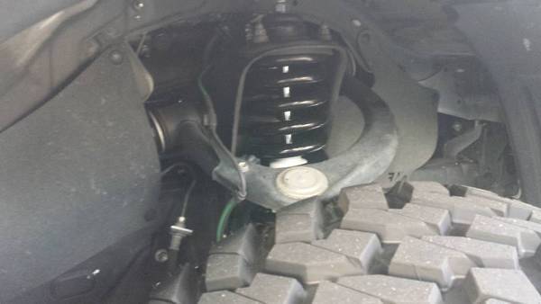

    Goijg to need a picture of the wheels themselves. No some cool picture of the truck. Would like to see this camber. Also take a picture of your uca showing how close they are to the springs

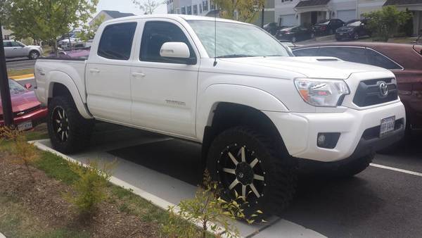

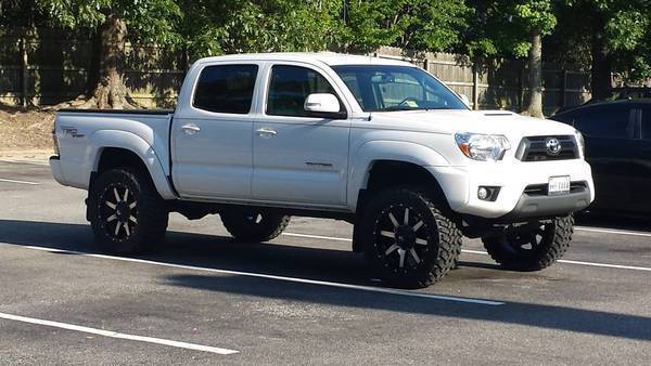

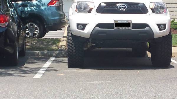

    357Sig, here are a few of the pictures. Not sure if they are quite good enough but it is just a slight bit of positive camber if you can tell.
    [​IMG][/url][/IMG]
    [​IMG][/url][/IMG]
    [​IMG][/url][/IMG]

    Your truck looks OK to me. I see almost all Tacomas with some positive camber (the specs are from 0* to .5* I think).
    If you notice any abnormal wear on the tires, then I would start worrying about the camber being too high.

    Your Camber and Toe should be as close to dead 0.00 as possible. Your Caster should be ideally 2.7 or higher. Yes that is "out of spec" but it is the correct setup for a 3" lift. If you cant increase caster thats not the end of the world but that toe and camber need to come WAY down

    is that with stock upper control arms? The camber is unacceptable and the toe could be brought in more

    you'll need uca to correct that, if it's not in the budget for you right now. Just keep an eye on the tires, to see if there is any uneven wear

    With camber like that the tires will wear unevenly, definitely not good at all. With more positive caster the truck will drive a lot better as well. Wheel alignment isn't something you don't want to ignore or not care about. Upper control arms should be on your list of parts when planning a lift kit.
    Totally agree^^^^
    Consensus is a lift over 2" will need an aftermarket UCA to get proper alignment numbers.
    At least bring the truck back to get that camber as close to 0.0 as possible and the toe to 0.0
    With 3" of lift and stock UCA's you will sacrifice caster for camber. I was barely able to get any positive caster while keeping camber at 0.0 with stock UCA's.
    I installed the Desert Products UCA's and was able to get 3.0 degrees positive caster and camber to 0.0. The difference in performance was unbelievable.
    Do you off-road your truck at all? The Light Racing control arms are a budget minded control arm. Total chaos is another popular upper control arm.

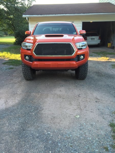

    I'm having the same problem with 3" lift. I put pro comp ucas on it. I haven't had it aligned since I did. Will it make a difference or am I wasting my time taking it back to the shop for alignment? I have bad tire wear pass side feathers real bad and drivers side wears inside real bad

    Sorry here's he pic
