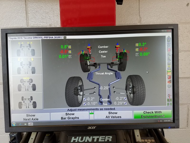

    20170421_105107.jpg With stock uppers and 3" lift u have to sacrifice caster for camber...and vice versa.
    They aligned your truck like this \-/ to add more caster so u don't float off the interstate at 80mph.
    Now if u do not like the pos camber look, then u will need aftermarket uppers.
    With mine...and stock uppers I couldn't get close enough to zero camber without sacrificing caster.

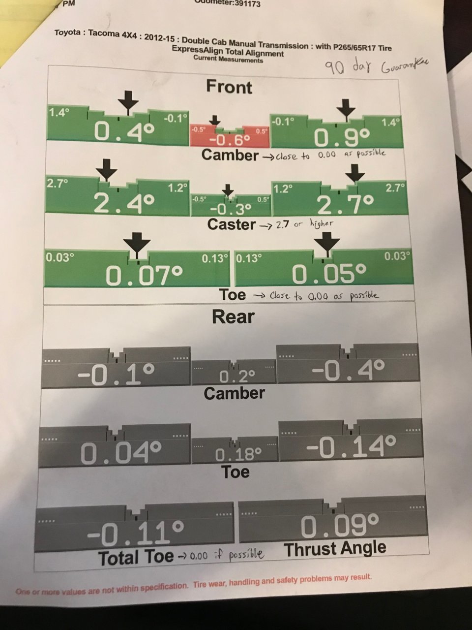

    Sorry to revive an old thread, but I'm seeing the exact same issues and I have the light racing UCA's from SPC.
    I have had it aligned 3 times since the lift in a span of 4 months. Twice at Toyota, 1 time and 4Wheel Parts. The positive camber is still visible on the passenger front. Wear is minimal, but the outside edge is definitely a little more round than the inside.

    I'm bumping this thread to see if any of you guys (or anyone else) have anymore on this at all. Though I haven't gotten an alignment in a year, I had 2 alignments since my 2.5" lift up front with JBA UCAs and have always still had visible positive camber but now I also noticed more wear on the outsides of my tires. My last alignment the camber was close to 0 and so was toe. Caster was at 3ish. Truck has been babied and only on a few dirt roads so no off roading or accidents or anything. How's everyone's tire wear? Why would our cambers show that they are close to zero on the alignment sheets but then visibly we can see positive camber and now more uneven tire wear?

    Having the same issue^
    I got my alignment today on my 2nd gen double cab tacoma and I notice a positive camber visually on my passenger side wheel as well. I am running king coils with camburg uniball UCAs. Not sure what my lift height is but I think it’s ~2.5”.
    Current alignment angle specs:
    Front Left:
    -0.1* Camber
    2.0* Caster
    0.08* Toe
    Front Right:
    -0.1* Camber
    2.1* Caster
    0.08* Toe
    Anyways, not sure why I visually see the positive camber on the passenger even though it showed up as close to 0* camber on my alignment sheet. My driver side LCA camber bolt looks maxed out to achieve close to 0* camber . But my passenger side camber bolt looks like its on the minimum setting with more adjustment to get rid of the positive camber appearance... My truck drives straight, don’t notice anything off. Anyone know how I can fix the positive camber look without throwing everything else off?
    Also, I was wondering if I should go up on caster on my alignment? I’m on 285/70/17 and the tires look pretty close to the fender well and I am experiencing rubbing.
    Per @Camburg UCA alignment instructions:
    ‘Additional caster is built into the Camburg arms to correct alignment issues that are inherent with lifting the vehicle. Have your alignment shop increase caster from the OEM suggested specs, then set camber and toe. Having an increase in caster helps with straight line stability and cornering precision.’
    My alignment tech kind of ignored these instructions and was able to get stock alignment specs with 2* of caster. Will increasing caster help better my alignment, move the center of my wheel forward away from the fender well?
    Thinking about taking my truck back in.
