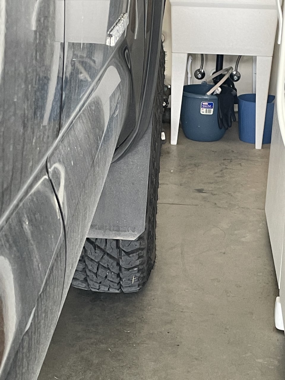

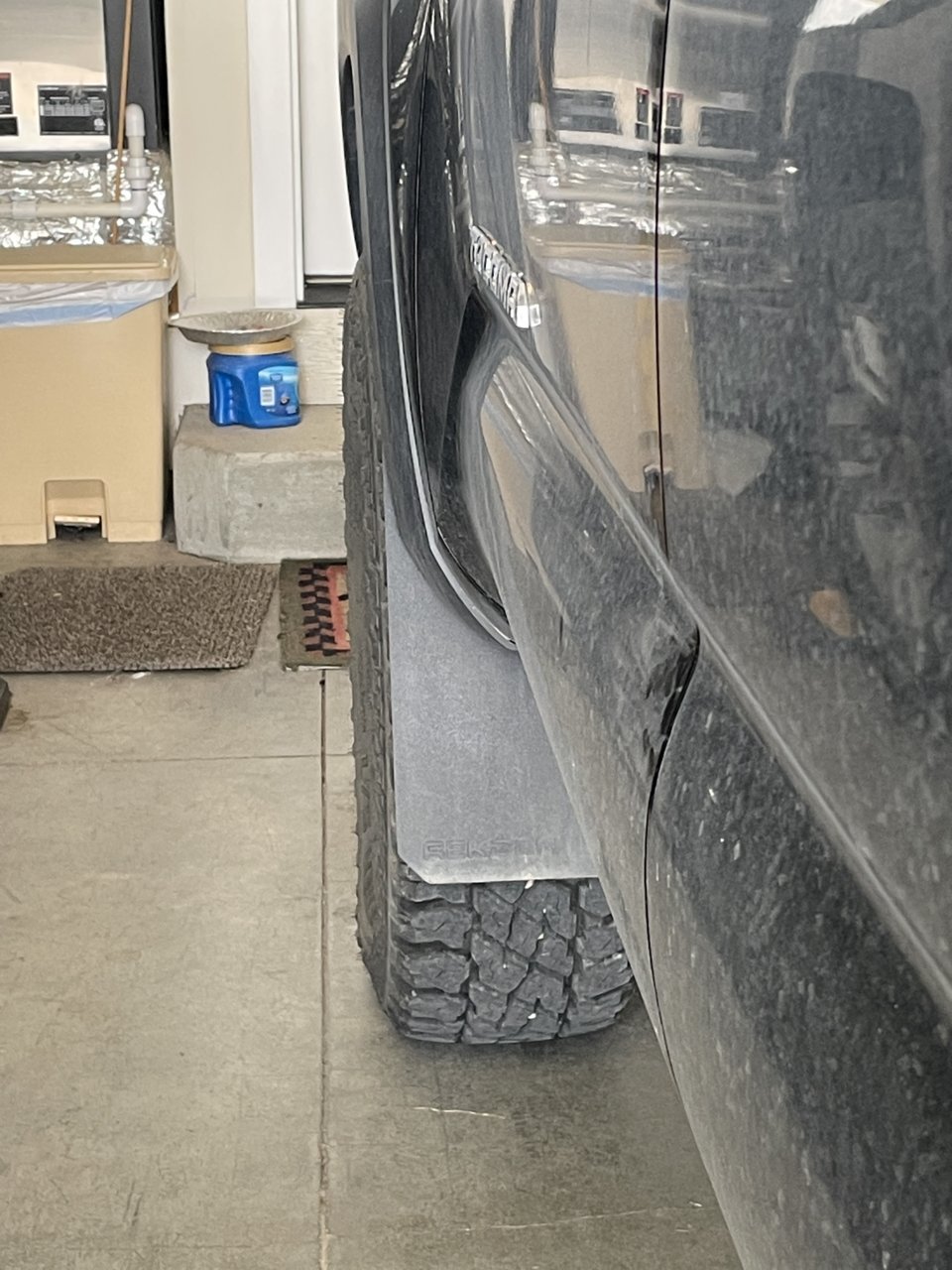

    I took a look today and it definitely looks like some tire wear on the outside edge.... probably after a thousand miles ... and before I just had it realigned.
    Before I just had it realigned -the passenger side looked like it was positive cambered -and that's the one with the most wear. (note: they did tell me they fixed some toe -i can't remember which tire or how much)
    Now, after having it aligned -they both look positive cambered.... Everyone (2 les schwabs and a dealer seemingly familiar with lifting ) tells me its good -but Im finding it really hard to believe.
    When u look from the front u would swear it looks like its riding on the sides of the tires (i should probably note i have 255/80/17). However, from the back it looks straight. camber specs are .5 and .6 .... heres some pics
