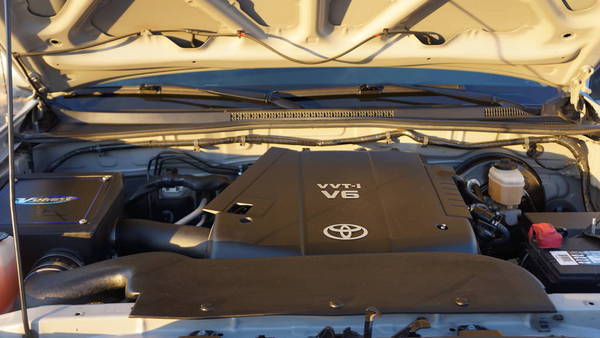

    just purchased mine when I get it i'll let you know how it fits got #18/640:rolleyes:

    did you have any trouble getting the engine cover back on?

    Getting the cover on took some tweaking. I had to adjust the intake tube so that it didn't sit on top of the valve cover and lay 'somewhat' flat. I could not use the left cover nut as Volant didn't have a stud on the tube (pretty lame design IMO). Also, the Volant badging did not come on my intake like on duppers1957 (posted above)
