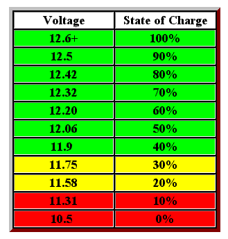

    A fully charged battery is 12.6-12.7 vdc, technically 11.9vdc is a "dead" battery
    damage to a regular "starting" battery occurs below 11.6vdc and more likely the higher the amp draw.

    As you can see from the chart above, it’s a fine line and those cheap volt meters are not accurate for may reasons. Both in connections (cig lighter) and internal electronics. They are a good directional indicator, or good as a reference point, but do not trust them to be an accurate indication of when you need to start your truck, or you’ll be sorry. Only accurate value is a quality hard wired unit.
