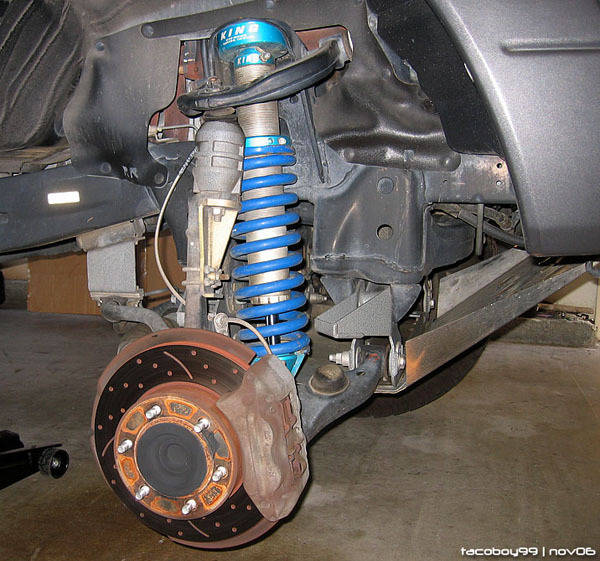

    you might also want to consider getting into a King 10" or 12" coilover to eliminate the spacer that goes between the coilover and coil bucket...
    example of an extended length King coilover on a pro comp 4" drop bracket on a 1st gen...

    i know huh... they been making that kit like that for years i guess... the spacer in between the coilover and the coil bucket is worse... hahaha...

    that kit is sketchy and i have ever seen the swayaway 6inch coilovers yet what do they cost im guessing alittle cheaper than the kings and fox
