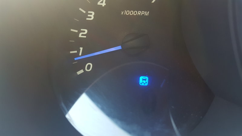

    Is it the stability control light? I just took it back to the shop. Came on right after alignment. 20160526_094511.jpg

    i have read that some experience this after lift or alignment and requires a VSC re-calibration.

    I disconnected the battery and ultra gauge and mine reset itself.
    Didn't have to go to the dealer the light shut off.
    I'm lifted - all pro exp springs in the rear and icon coilovers in the front.
    Hope your light goes off.

    After several lifts and modifications on my second - second gen taco .. when this happened to me all I did was disconnect the battery for 20 minutes or so, reconnect and the light went away.
    One time it didn't go away after a lift, so I went to get an alignment .. light was off afterward.

    Battery disconnect procedure worked.

    Your alignment shop should have recalibrated the VSC. I am glad it's off, but it needs to be reset and it should've been included in the alignment.
    Mine was off 30 degrees after my lift was installed, which is outside the parameters to begin with.
