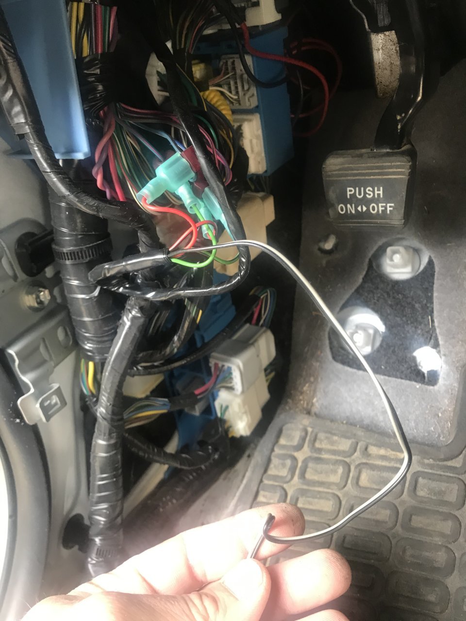

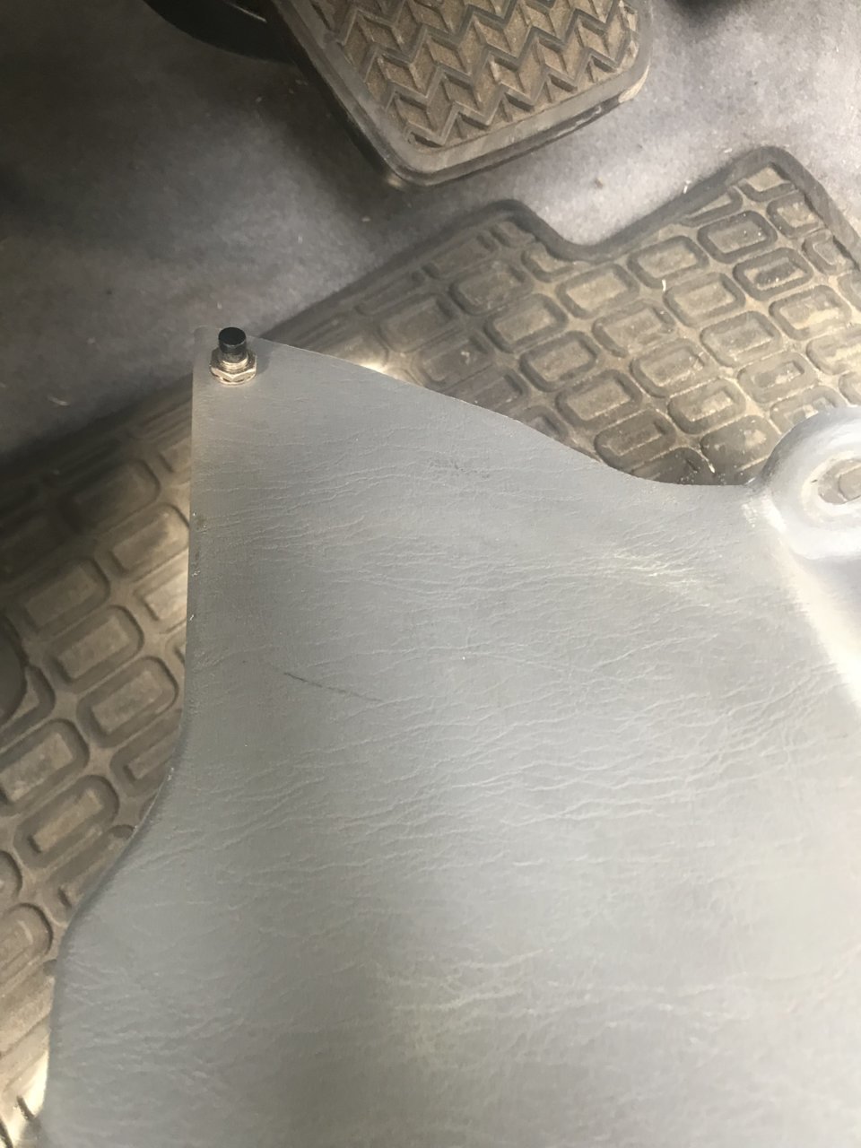

    So I go out this morning and I have decided I’m going to do a vsc kill switch mod and the ywm. On the front of my drivers side kick panel I find this. And have no clue what it is. 765C3D49-16E5-426C-A0E3-42CA5498215A.jpg3201F524-BB78-4A6E-A1EB-810E73A9F02A.jpg
    Anyone have any thoughts on this. The button doesn’t seem to turn anything on or off but it’s definitely wired to something
