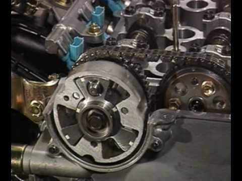

    Okay, so the is the inside of a VVT actuator:
    (not a toyota, just the first good picture I could find)
    This allows the ability to adjust the timing of the camshaft + or - a set number of degrees. More advanced timing creates power, and more retarded timing reduces the power and saves gas. It is controlled by oil pressure regulated by this:
    This is a Toyota oil control valve. It is controlled by the ECU to achieve a set number of values to satisfy the tune.
    Hope this helps
