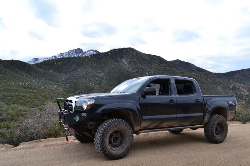

    Doesn't look bad to me! This is Jake's truck (Kyouto42) with Fox/TC up front and All Pro Expo's/Fox in the rear! In person there's a slight rake but looks bad ass still!
  20. May 1, 2012 at 10:29 AM
    #20
    ff.hogue
    ff.hogue [OP] Well-Known Member
    Apr 29, 2012
    #77834
    63
    Redwood City, Ca
    '11 DCLB 4x4 Sport
    and it begins...
    good looking truck but not the look I'm going for. looking like the progressive overload springs are going to be what I'm looking for
