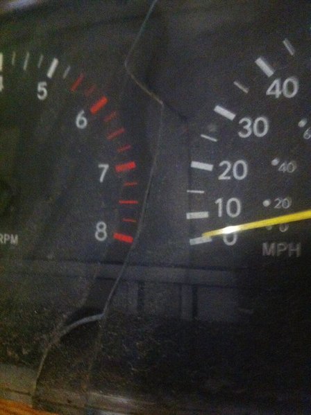

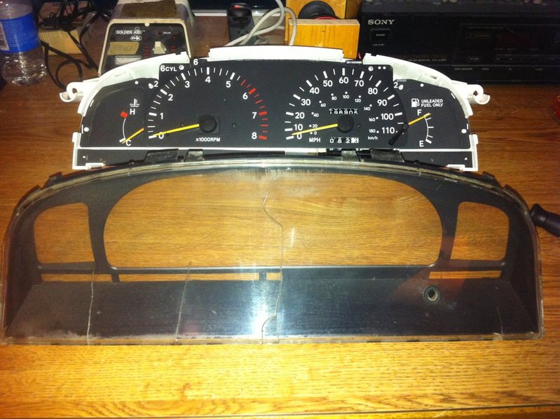

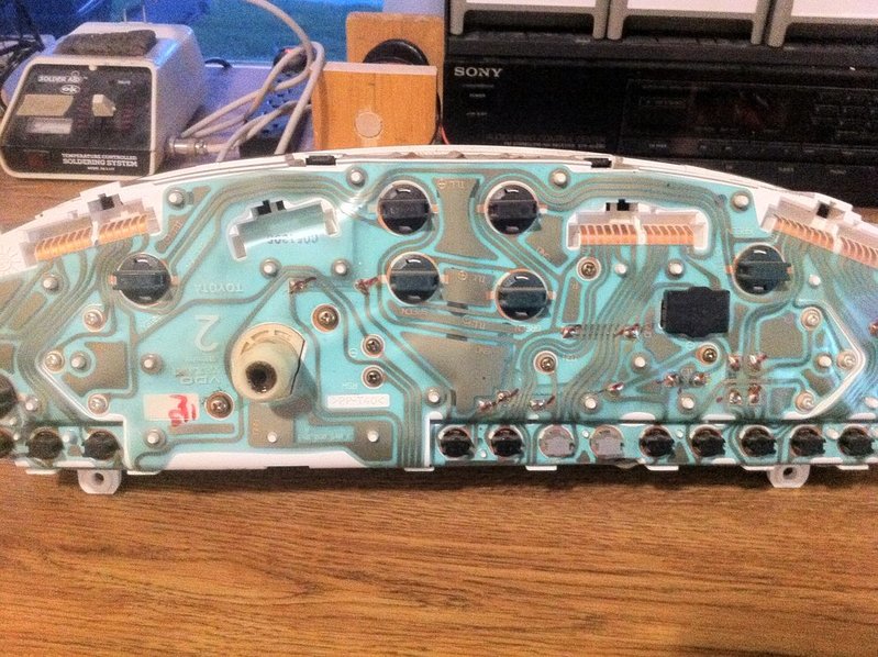

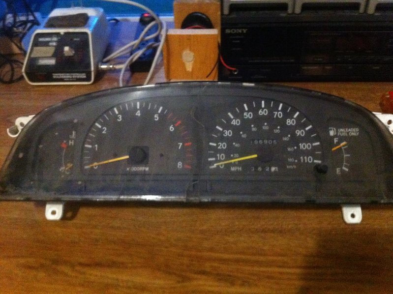

    Well being that I'm still on the search for that cross member I decided to work on other small things.
    Today I pulled the radio and the instrument cluster. Surprisingly given some the questionable things around the truck the radio was wired with a proper plug and the wiring harness has not been cut on! Its also very apparent that someone spilled soda across the dash and let it seep in. So everything is all sorts of sticky and dirty.
    Got the instrument cluster out, it was just a hair dirty.
    I've had the dash out of the 2000 so I thought I knew what I was doing. Forgot a few things, but the big issue was the fact that the 2000 has a digit dash and this doesn't. Therefore it makes it seem like the dash is really stuck, until it all comes apart when your hand is fished behind trying to find what the cables are caught on.
    Planning to get new dash lights as the current ones were out. Also wanted to get a better look at the crack:
    As it turns out this goes pretty much all the way down and around the plastic face. So I'll have to replace that. Verified that the piece is removable. So I should be able to replace just that piece and not the whole dash, assuming I can find one. I guess I will attempt to glue it back together for the moment.
