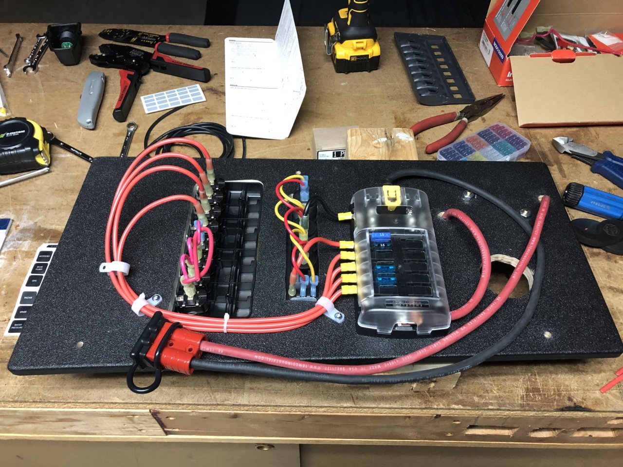

    sorry if it’s a stupid question. But why specifically the 40amp breaker? I’ve been studying many systems trying to make my own schematic and have seen multiple people run 30amp and 100amp as well. All similar outputs it seems too

    Not stupid at all! It is based on my possible total amp load/draw moving through the system and wire size handling the load. 40amp being more than enough to protect the most I am ever going to have running through it. Others may have more draw or planning to have more draw as they add more to their system.

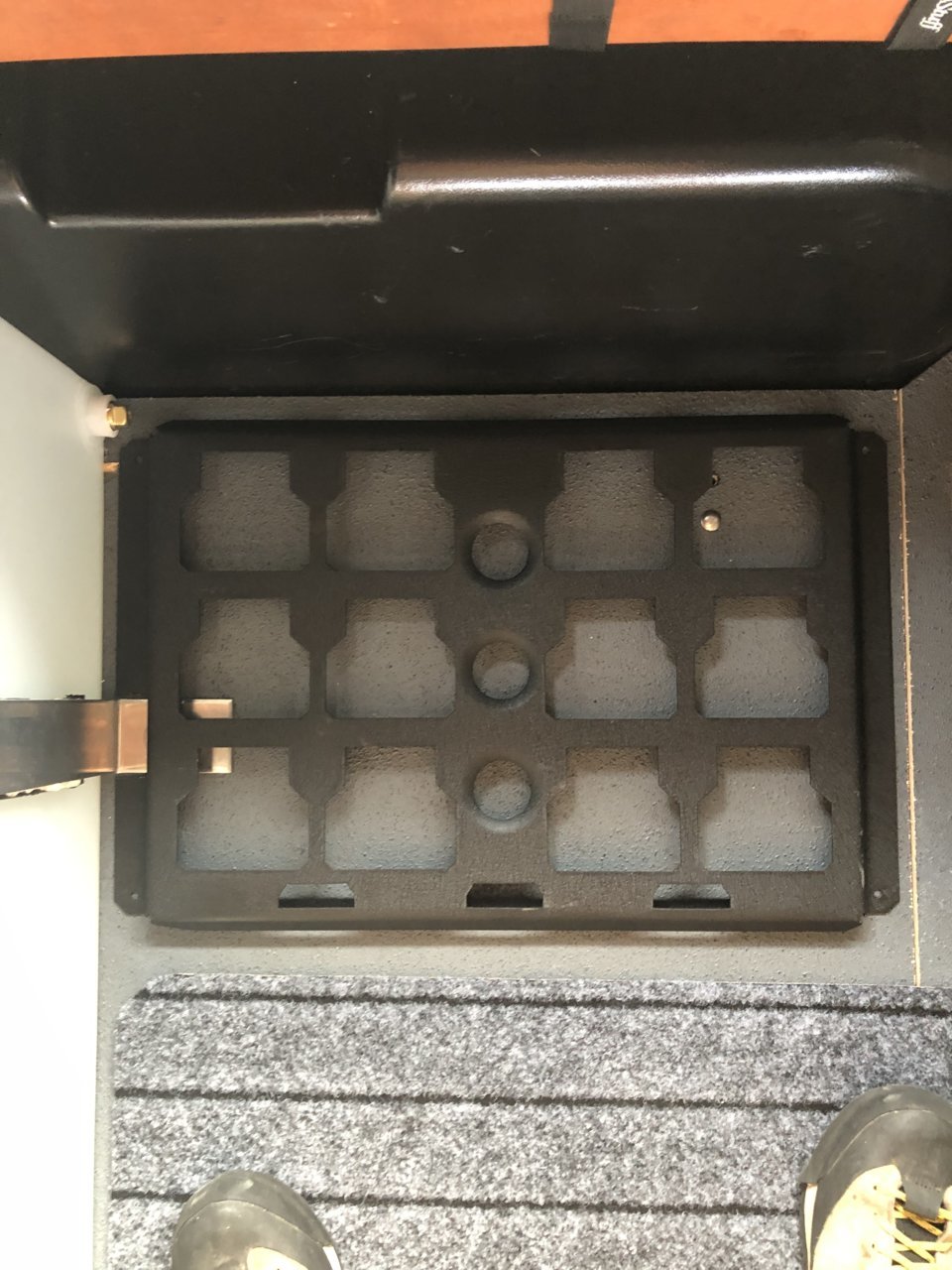

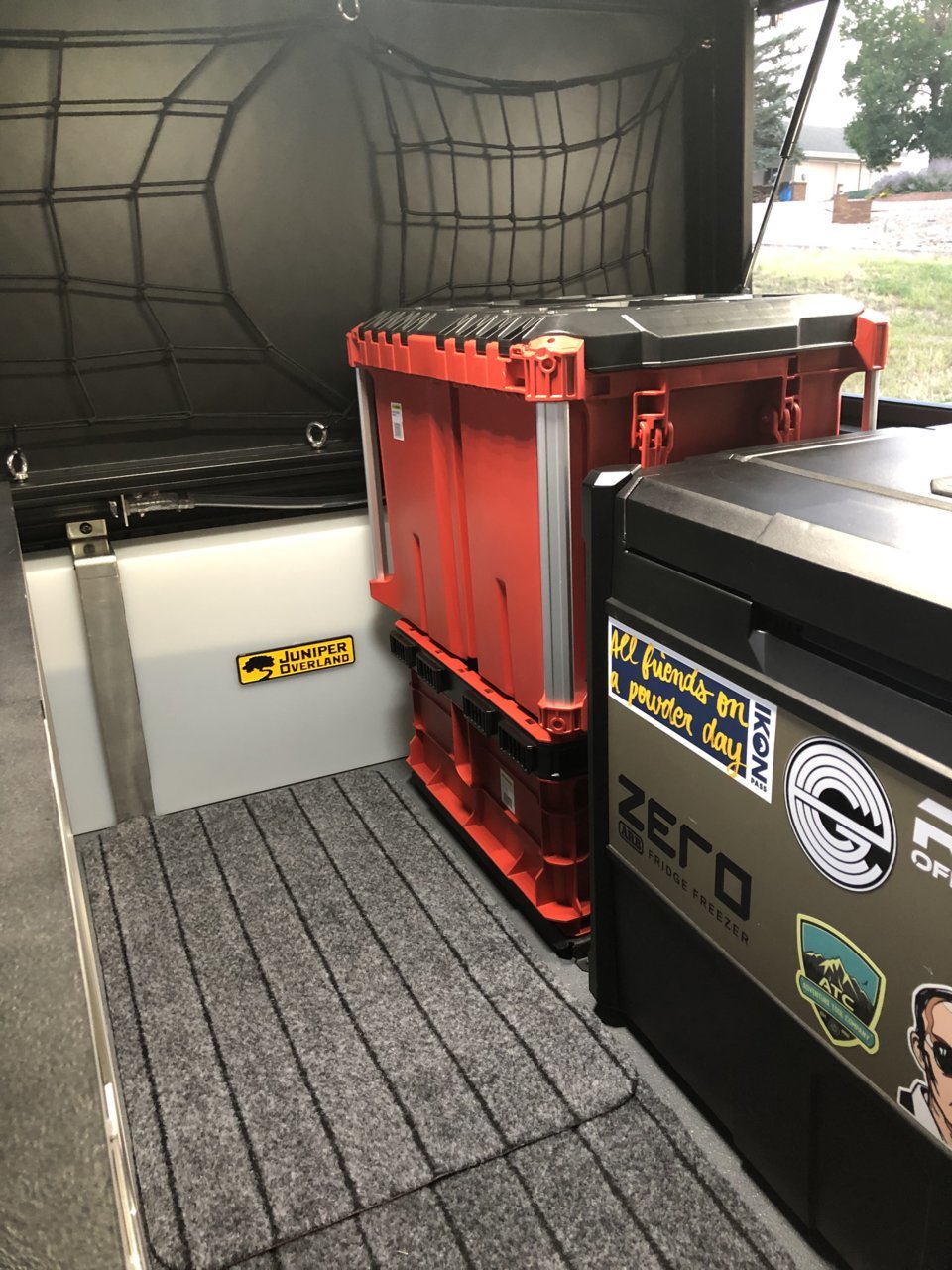

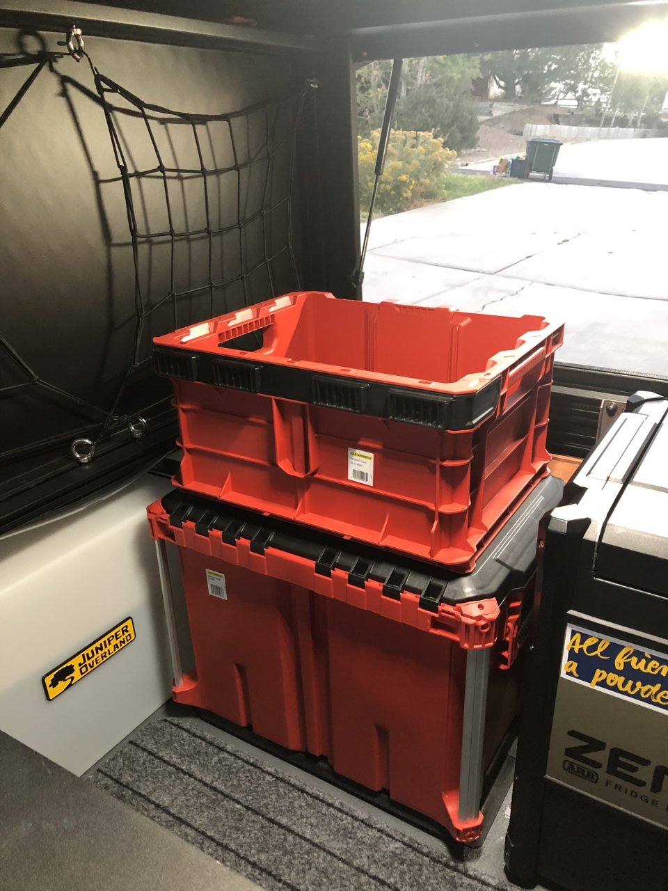

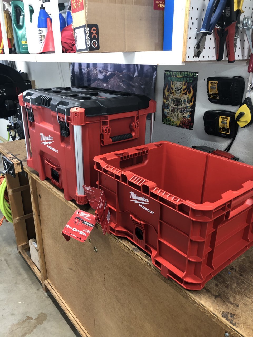

    Well, I have been pretty dead on here since winter has come, and no camper work to speak of has really been accomplished since the snow started flying. Mainly b/c I just want to ski with all my free time at the moment. That being said, I did finish a few things before winter hit that I haven't updated on here. First I decided to go with using a Milwaukee Pack Out box & crate for dry food storage until I decide if I want to build anymore permanent storage on the passenger side of the truck. This has worked out pretty well for us as we used it on a couple fall trips.
    I got this large tool box & "fancy" milk crate using some gift cards I had collecting dust.

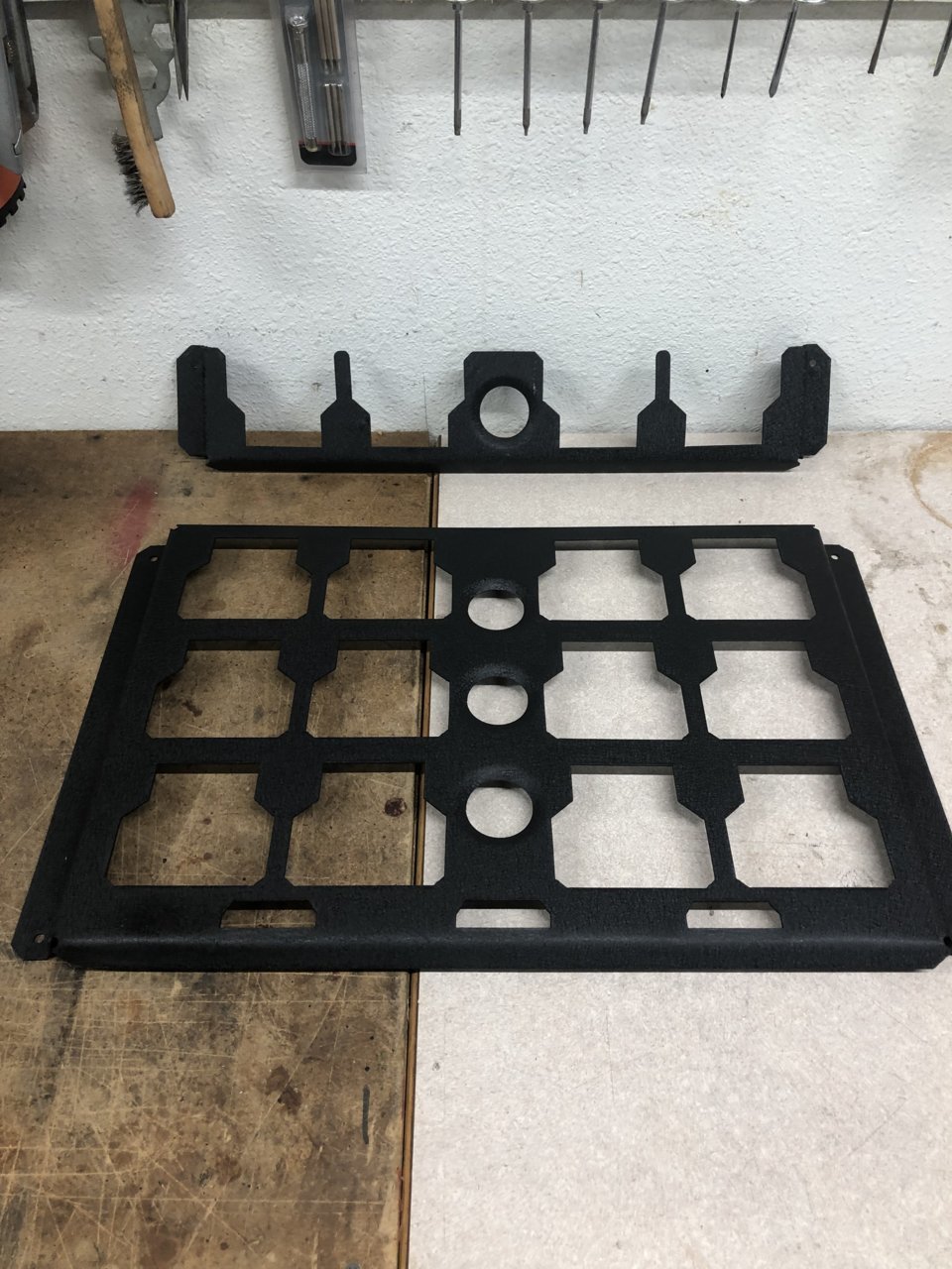

    Then after realizing the Milwaukee brand mounting plate was going to be too big for the space, I found these metal ones off Ebay that people water jet out and they were the perfect size. There is a huge DIY community for this Pack Out stuff. All kinds of stuff.
    That being said, I did have to modify/cut some clearance off the one end for the water tank strap so I could mount it to the base plate.
    With the mounting plate secured to the base plate, I can lock the two into the floor in either orientation I want (crate on top or bottom), but we decided the crate on top works the best for us. I wouldn't want it much tighter than it is, but I can remove them from inside or from outside the side window if need be & lift them out. What we have found works the best is we leave the crate empty and then at meal time we use it to carry out dry food or fridge stuff from the camper to the "kitchen" so we haven't even needed to remove the big box at all.
    It isn't a bad temporary solution at all for now and we can access it easily inside or outside the camper. It also is rock solid when locked into the plate. The truck/camper got a pretty good rock N roll session in the fall over Hagerman Pass and it never came loose.

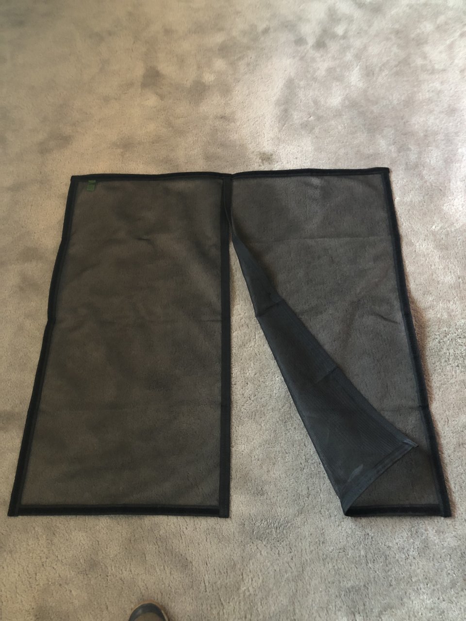

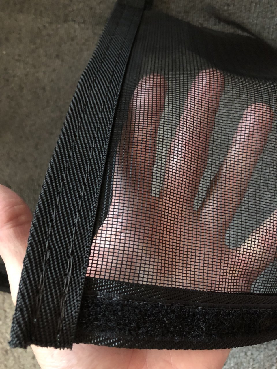

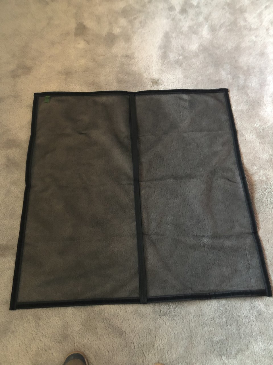

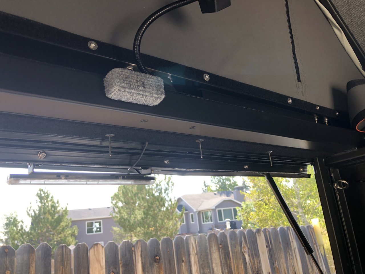

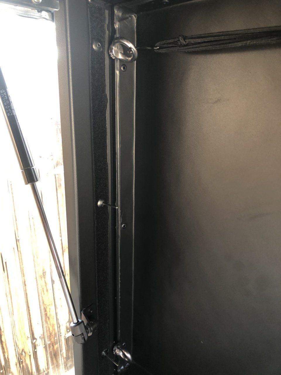

    Finally, the last thing I did was get this higher quality bug screen made for the rear door as I had mentioned months ago, that my Amazon one just didn't hold up to the abuse. It performed well, but I didn't get to use it much before cold weather. The design is similar, but it's made from much higher quality screen and other materials that promises to hold up to being taken up & down, folded etc. I am considering offering these for sale possibly in the future (because like me, you may prefer a screen that doesn't require zipping & unzipping all the time). More on that as I get to test it more this summer.
    The main difference other than the high quality screen is that in addition to the magnets that pull it close at the split, there is also fiberglass rods that support the entry which make it easier to push open and then fall closed behind you.
